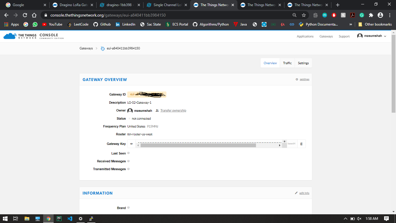

I am using LG01-N Dragino gateway. I was using this to collect data from LoRa Arduino shield. I was just using it yesterday. But when I started using it today, it is showing not connected. I do not know why. Please help me.
This is a single channel gateway that whilst appearing to work, is not supported by the TTN community as it disrupts the network. Please disconnect it immediately.

It doesn’t matter, they are not LoRaWAN compliant so we do not support them on this forum and because devices that are LoRaWAN compliant use any of 8 channels, you will be blocking transmissions from other peoples nodes and as we are a community network, this is not a good thing.
