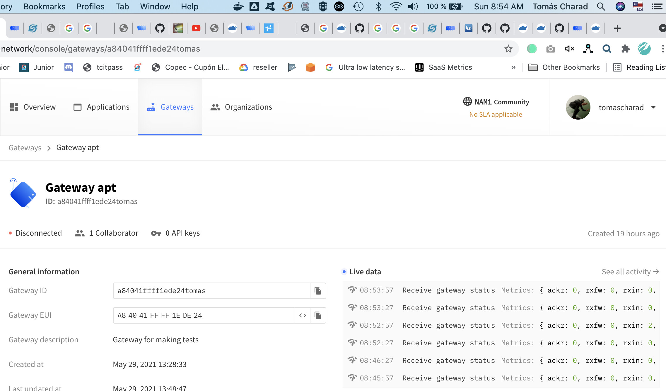

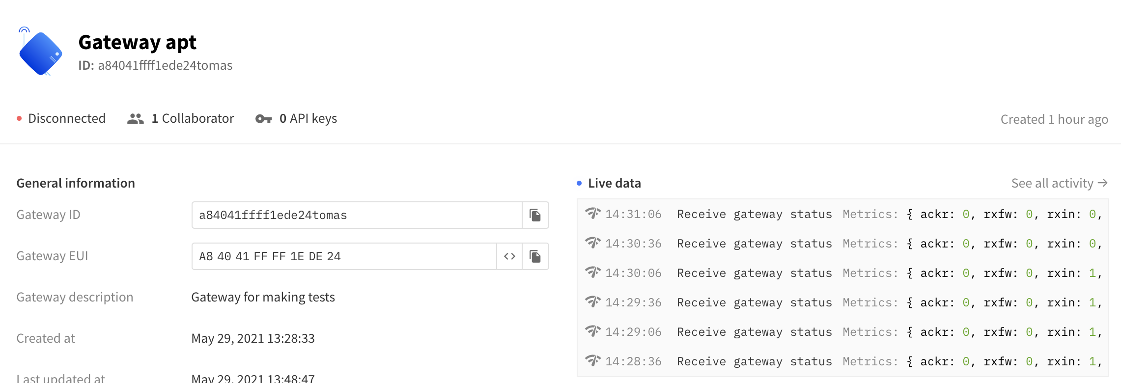

I’ve spend some time setting up the gateway and it seems that is receiving data, but it shows as disconnected.
I’m using a Dragino LIG16 on V3.
What could I be doing wrong?

Hi!
As showed in this new image, you can see that data is being sent every 30 seconds, and that the time of my computer is ‘live’ with the data being sent (8:53:57 las packet vs 8:54)

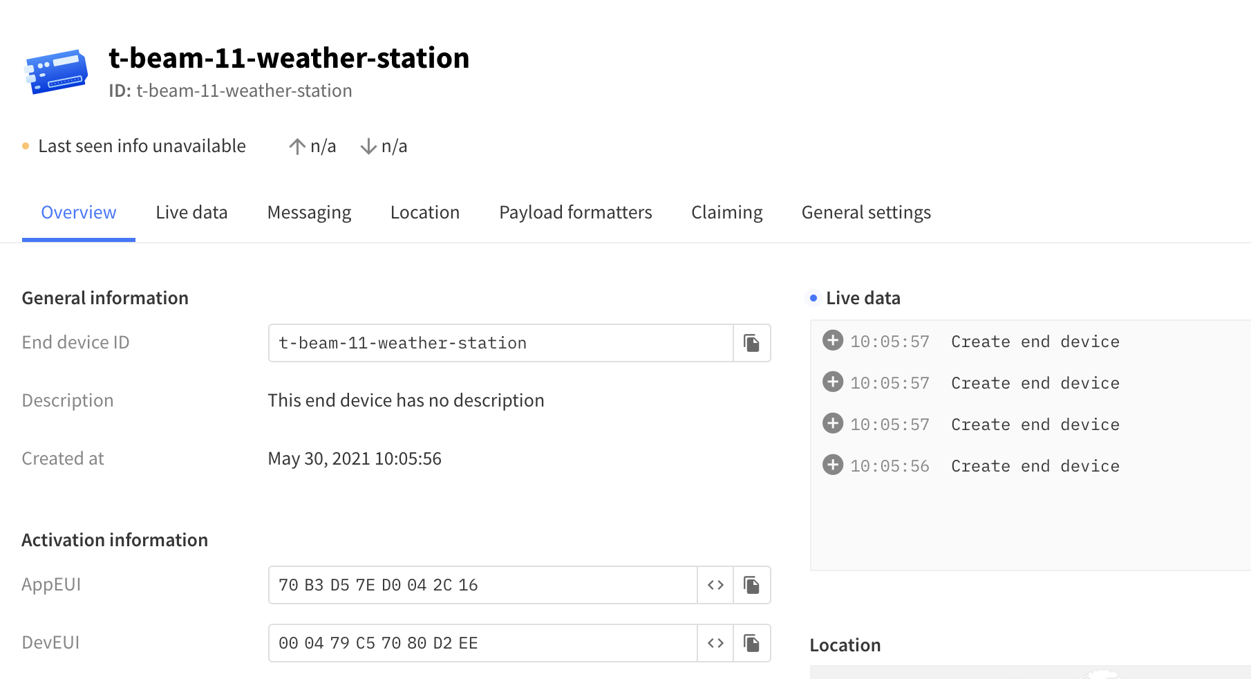

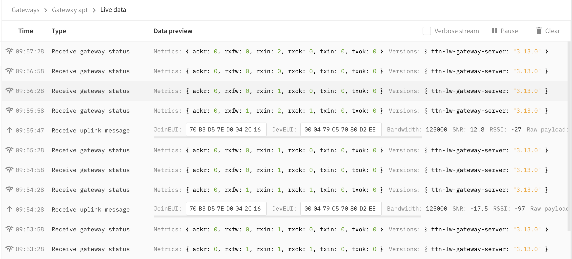

I’m trying to send uplinkgs with a T-Beam now. Will let you know when I’m done.

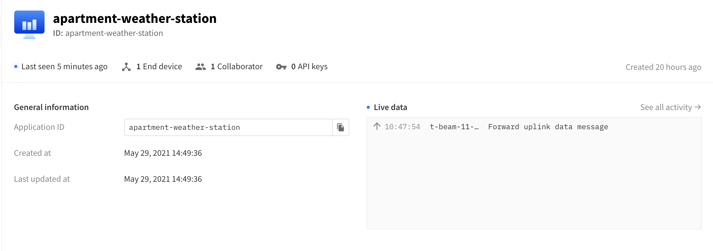

Yeap, receiving uplinks, still not showing as connected (But the app is not showing as connected either, I think is not joining).

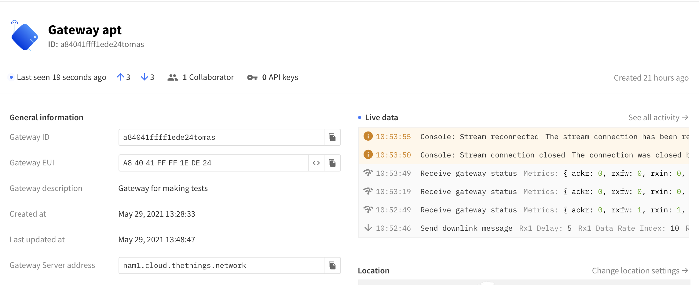

Everything is working now!
Don’t know exactly why, maybe I just had to wait to the end device to make the OTA activation?
