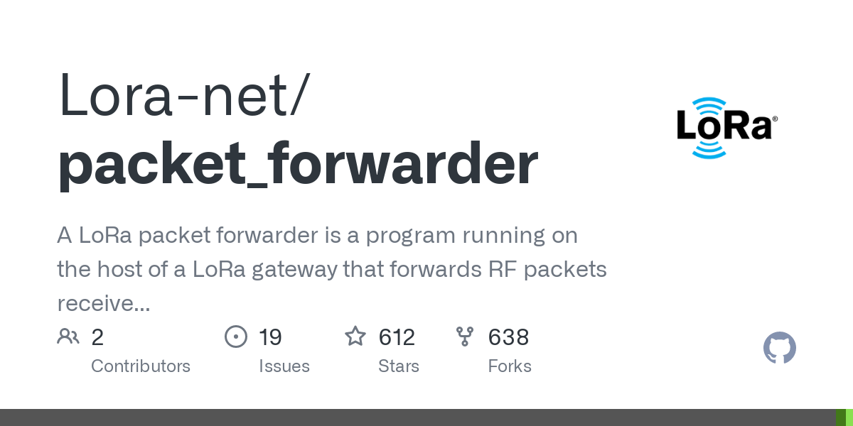

By that do you mean the one put up on Github as an open source project by the TTN/TTI team but now long deprecated & unsupported or some other ‘as used on’ TTN? Source?
I’m using this one, sorry for the bad information…
The new global_config file was copied from the TTN Console after adding my Gateway. In the local_config File i only changed the Gateway ID
