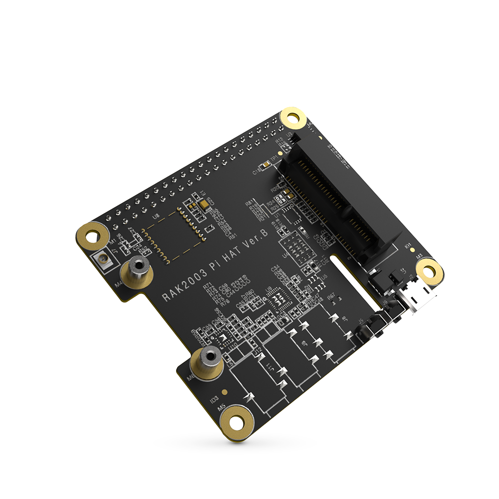

Something like this
Note this is for the 2287 or the 5146 - not sure if ok with the 2247
Alternatively look at the RAK2245 RPi HAT
RAK2245 Pi HAT Edition | Fully Functional LoRa Gateway Concentrator Module – RAKwireless Store - a concentrator on a RPi 40pin connector directly.
