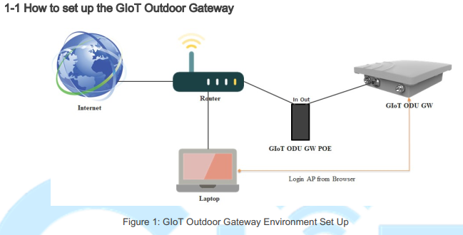

I have a issue with my Gemtek outdoor gateway. My gateway can’t join WAN network. I know the MAC address of it and when i check my router, I dont see it’s MAC address in DHCP list of router same as manufacturer document said. So, i don’t know what is IP to config my gateway.
Anybody ever face with this issue ?
Are u using Ethernet WAN or Wirless Extender?
Once you login and configured the Gateway with right Server address and Port under GIOT .
Try to connect with Internet . It should work.
Or share the Config for better understanding
Hi @madhuvarsha,
Thank you for your respone. I am using Ethernet WAN. I think my issue is related hardware. I don’t know my Lora gateway IP because it’s not exist in my router DHCP list. How can you know your Lora gateway IP.
I tried the connection as shown in the picture but it’s not work.
The problem is due to the Power Supply. When i use other Power over Ethernet device, it’s work.
