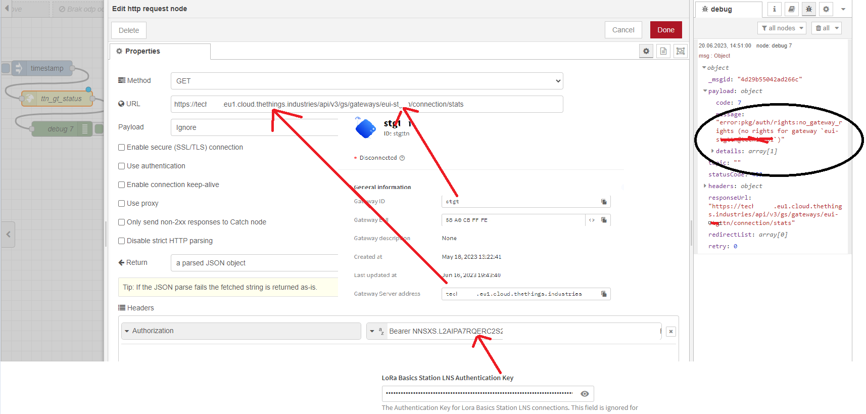

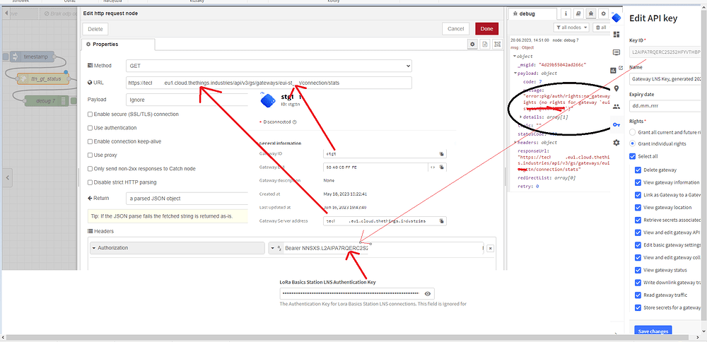

Trying to get my gateway status using node-red (get request)
Can someone please point me what i am doing wrong ?
Looks something wrong with credential , but i dont know from where to get token id - of course it that the case of issue…

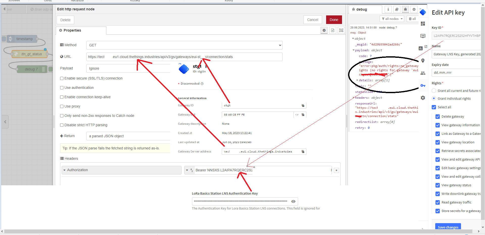

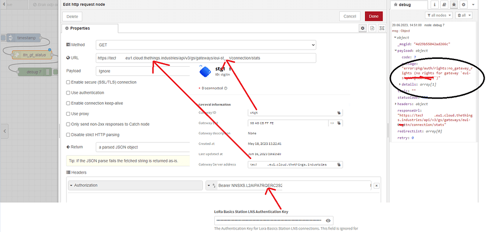

I think i am bit closer, now i getting 403 error which is - "error:pkg/auth/rights:no_gateway_rights (no rights for gateway eui.....l)
My question is how to grant access to that gateway ?
Anyone can help please ?

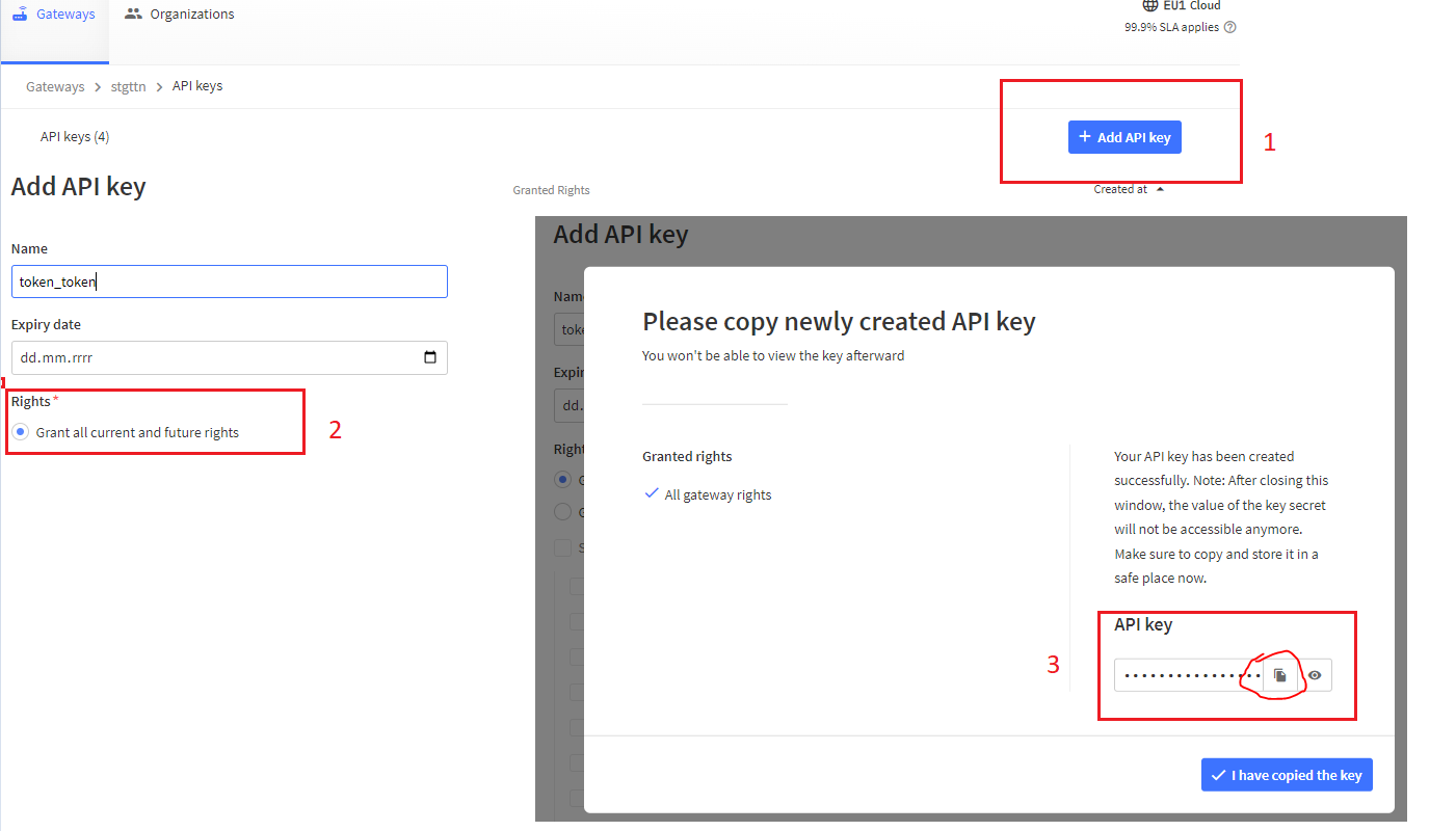

Have you created an API key? That should have access rights which you can update to include these rights.
Hi Jac,
Yes i have - my Bearer looks as follow Bearer NNSXS.XXXXXX.XXXXXX .
What else could couse error ?
The Key ID is not the API token, when you created the token you should have gotten a message telling you to save it because it could not be retrieved later on. If you no longer have that token you will need to create a new one. That token is what is required in the request,
Hi @kersing
Here is what i doing now , using key picture and still some issue.
Probably token i should generate somehere else…i am new here so sorry if asking such easy question
That looks right, however I sometimes have issues when using the copy button so I usually display the key and use select-all and copy of the contents of the text field.

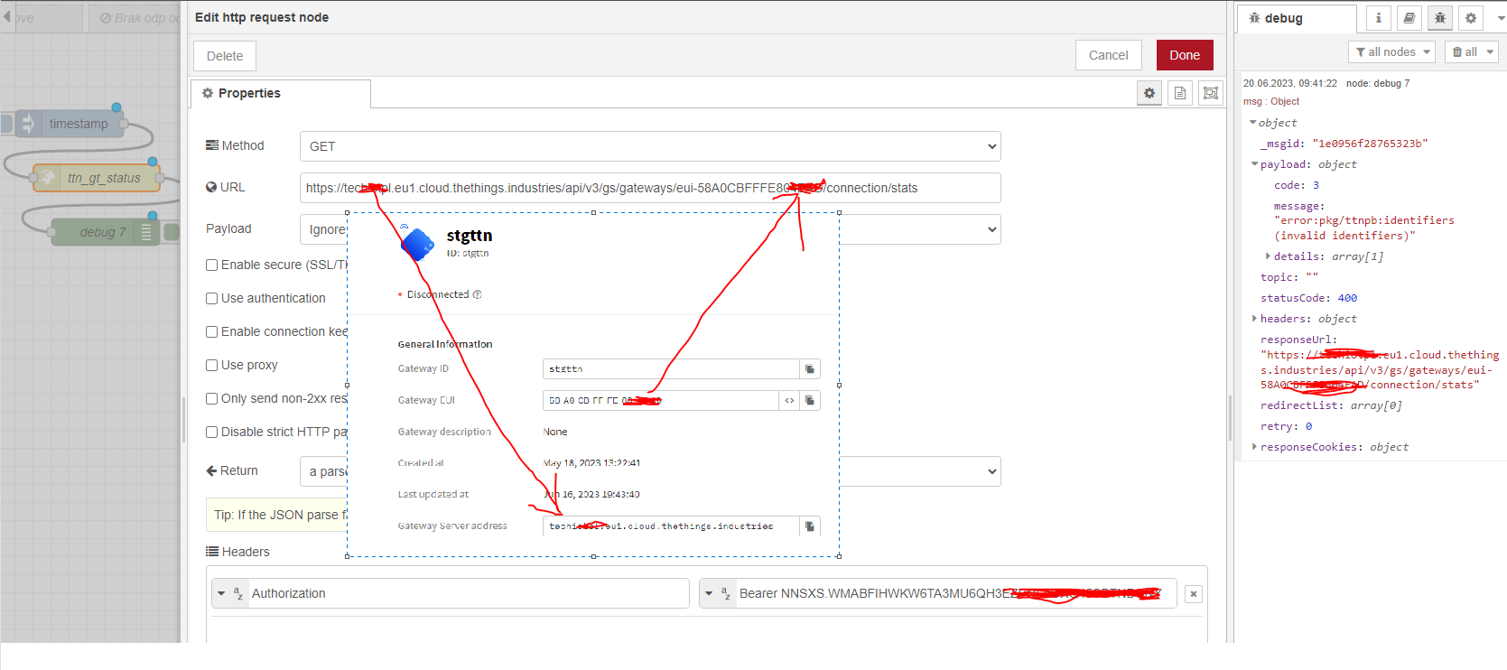

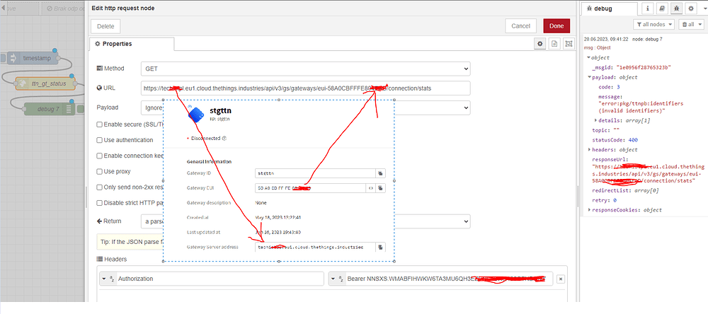

I think I am doing something wrong. I keep getting posts even though I powered the gateway off and they look the same. I have this message in the payload " error:pkg/ttnpb:identifiers (invalid identifiers)" and a few other what look to be errors. What I did was create an API for my gateway, copy the token, then updated the first node in your flow to specify that API token and the eui of my gateway. Then modified the 2nd node with the correct North American url.
Did I miss something?
Figured it out! Your gateway ID is your EUI, mine is not. I made up a name as a gateway ID when I registered it so that confused me.
