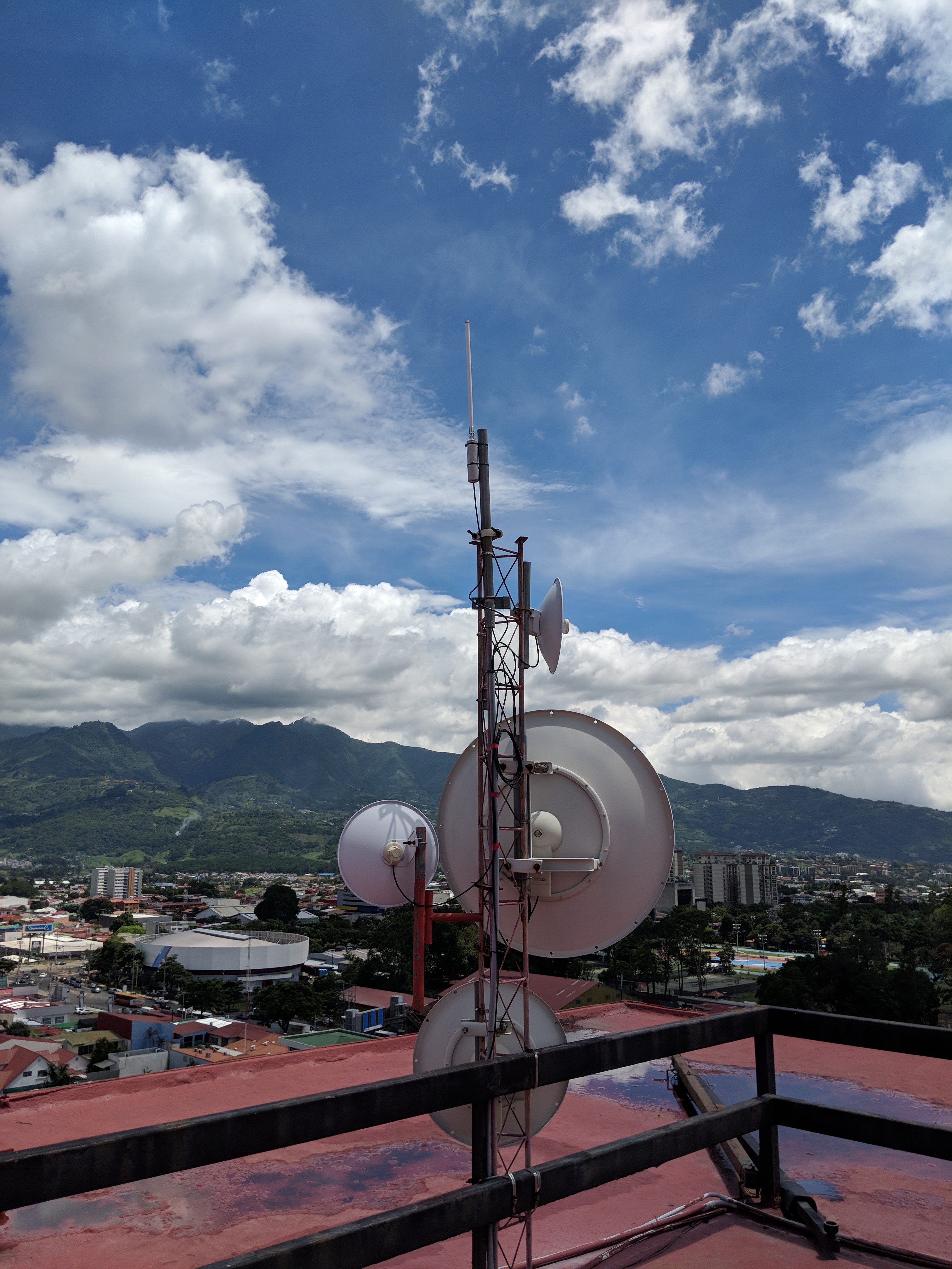

@jabq I have three TTN gateways currently running in San Jose, CR (2 indoor, 1 outdoor). One of them is located on top of Centro Colon and gets quite good range. Depending on where you are located in San Jose you should be able to connect.
Indoor gateways:
  • RAK831 + Raspberry PI (installed in minutes, solid as a rock)
  • TTN Gateway (with the latest update it now seems to be better)
Outdoor gateway on Centro Colon:
  • LorixOne
