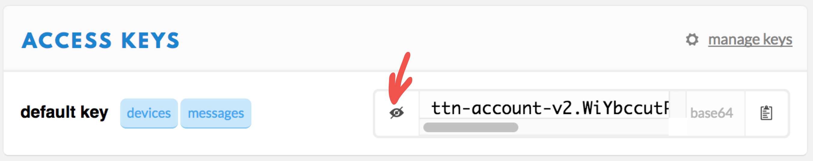

If your application is called ‘2222’, then in the console open the overview for the application and it should look similar to this, just copy the key using the icon:
Screenshot_20180309-183712
Thank you both for your quick response.
@nicbkw - thank you for suggestion for looking at the overview of the console. That resolved the issue.
My mistake was to be entering the App Session Key for the device I registered.
@arjanvanb - ‘ev’ is a typo on my part when writing the question on this forum. I was using ‘eu’ as the region.
