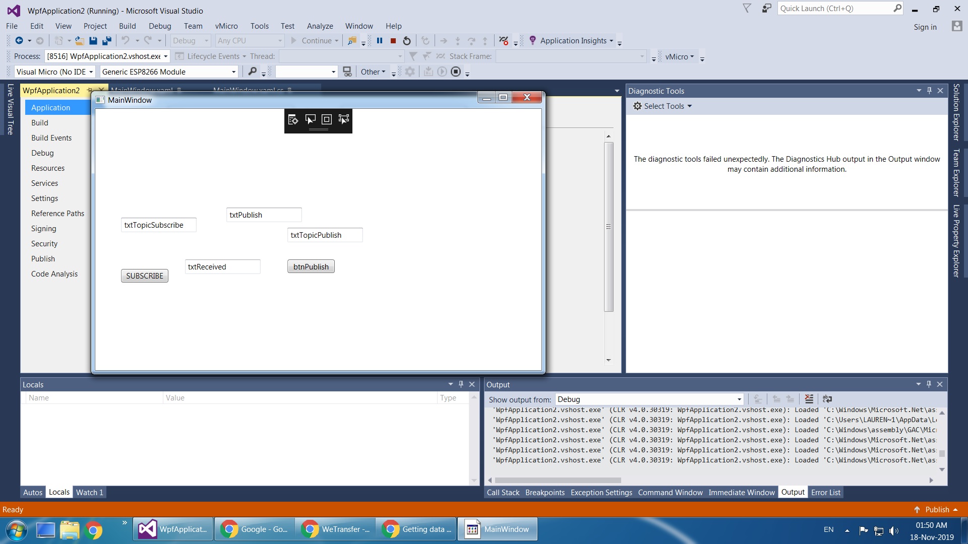

Hello again !
I tried the sample from here : https://gist.github.com/cwschroeder/7b5117dca561c01def041e7d4c6d2771
compiled with Microsoft Visual Studio C# 2015 as a WPF Application and it doesn’t work at all …
I get no errors but when I click the buttons nothing happens…
Here you will find a screen capture with the running code :
Screen Capture
Can you tell me why ?
Thank You !

Can somebody tell me why the GitHub sample from the link above is not working even if it is running without any errors? (when I click every button : it does nothing but the code is running. I tried display a message in the click event of the Subscribe button and the result was : no message. I don’t know how to debug that sample).
Thank You !
Topic and ceredtials right? See https://www.thethingsnetwork.org/docs/applications/mqtt/api.html
Topic: [AppID]/devices/[DevID]/up (You can use + as a wildcard, so maybe +/devices/+/up)
Server: eu.thethings.network
Username: [AppID]
Password: [AccessKey]
