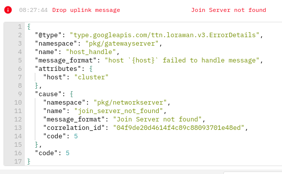

I have a rak 7258 gateway connected to stack v3. Gateway is connected but reports “Drop uplink message” with data showing “Join server not found” when client attempts to join.
I’m running in docker.
Any ideas ?

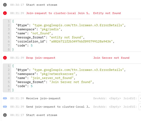

Hi, I’m having the same issue. I’m trying to deploy a private TTN enviroment with the stack v3.8.4 and I managed to configure the gateway. Now I’m trying to join a device.
I have a Multitech Conduit AEP as gateway, configured with packet forwarding as says the guide.
In the other side I have an Adeunis pulse sensor with OTAA verification, I registered to an App following the console guide.
Right now I’m stuck because I don’t know what to check to resolve this join fail of the device.
This is the activity of the device (image attatched):
Thanks,

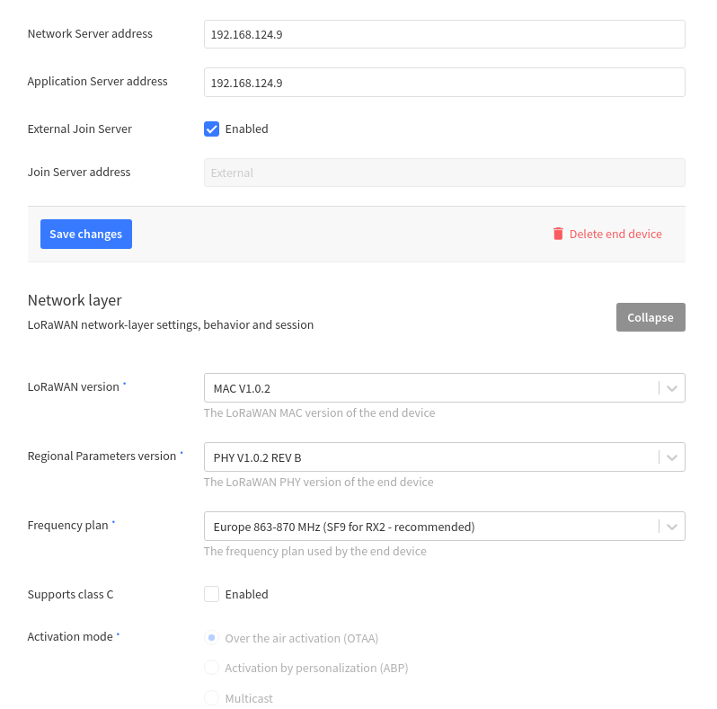

This is the rellevant information about device configuration:

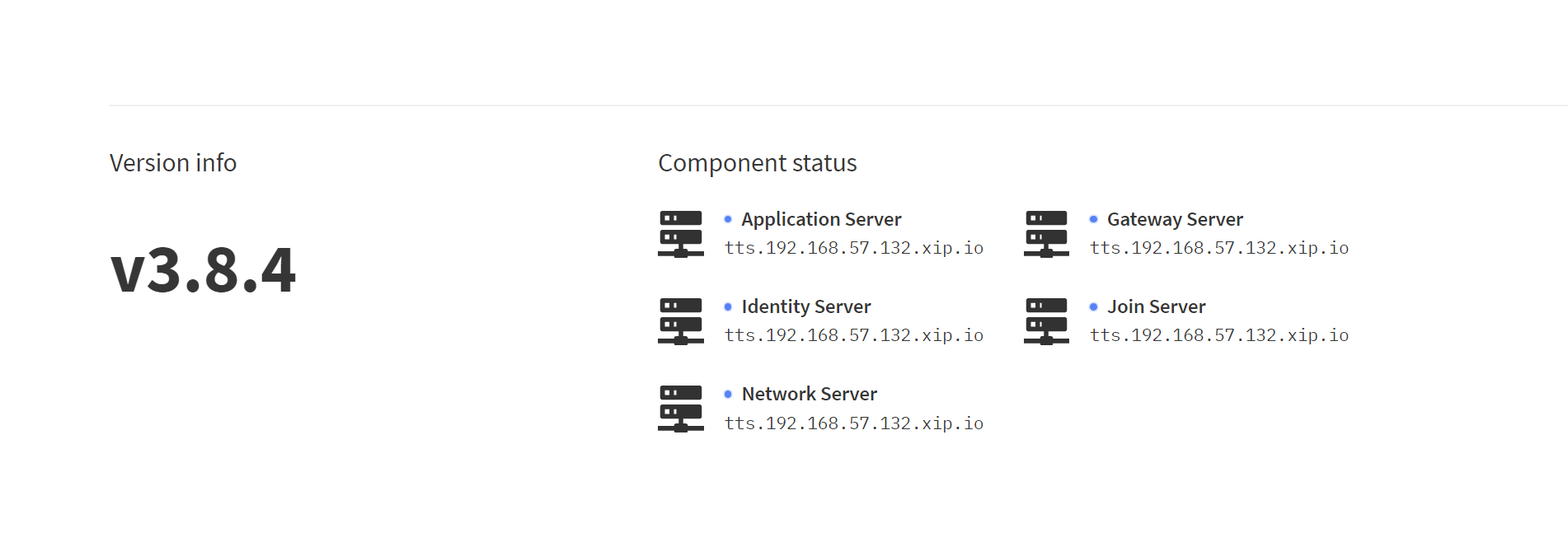

Hey @MarcRomero, Are you running in docker? I had the issue and unticked “External Join Server” but if you are using an external join server than i’m not sure but would make sure the correct ports are open. think its 8001 from memory.
Hi @dbrosy, Yes I’m runing it in docker, I dont think I’m using an “External Join Server”. The machine with stack and gateway are runing on a local network.

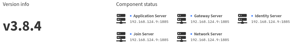

This are the servers (all are at 192.168.124.9:1885):
Sorry If I’m not specifig but I’ve just started to test the stack v3 and I dont know all its funcionalitys.
This is mine.
not sure why all your Components are showing the same port as acording toconfig they should have different ports

I thinks now its working, I’ll do some testing. I didn’t realize that by default External join server is ON, I’ve unchecked that option and configured the appKey.

Glad you sorted that out @MarcRomero, sorry about the confusion. We’re encouraging device manufacturers to provision devices on Global Join Servers as it makes connecting and transferring devices much easier, and so we initially enabled the External Join Server option by default, but we’ve changed that in future versions until we see more widespread adoption.
