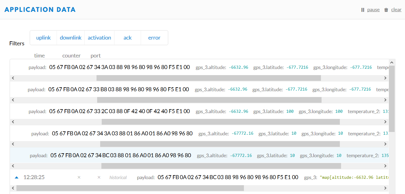

So I am using Dragino Lora GPS Shield to get the gps readings. The tiny gps example works just fine but for some reason in a different code , I am unable to get the correct readings. I have attached the code and the thethingsnetwork payload image.
