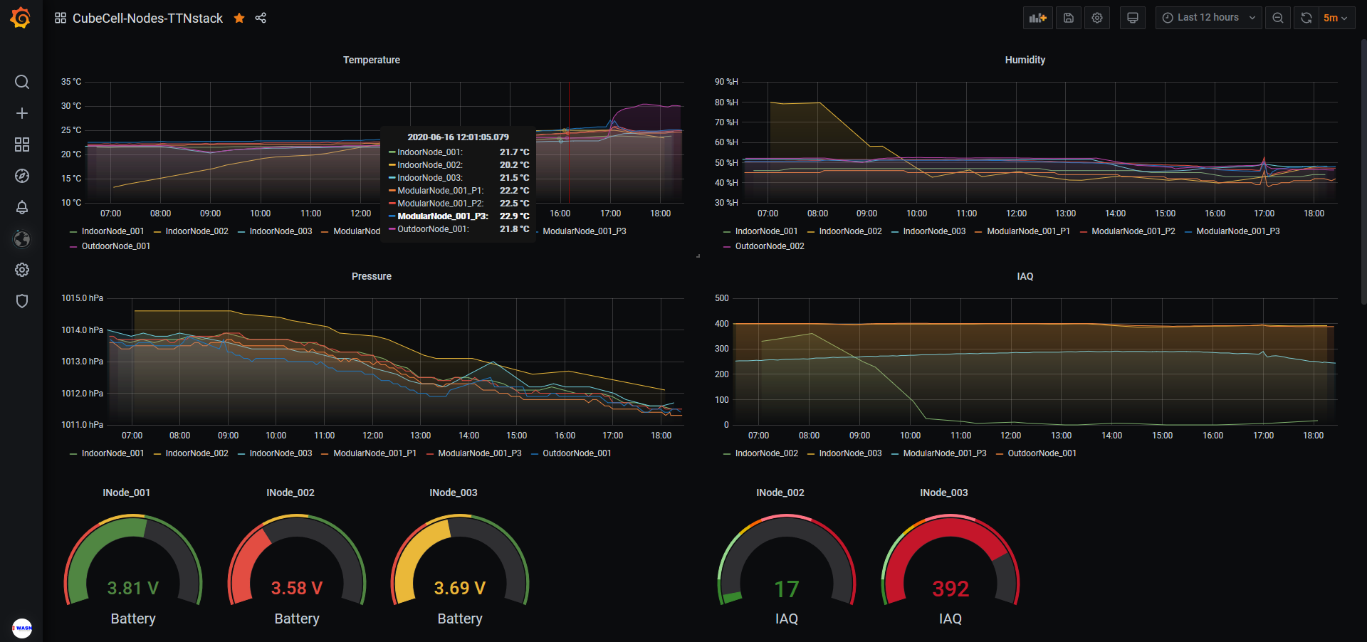

i am using telegraf to subscribe to the mqtt topic of my application and store that data to an influxdb.
than i create my dashboard with grafana.
this is a dashboard for my devel nodes in grafana:

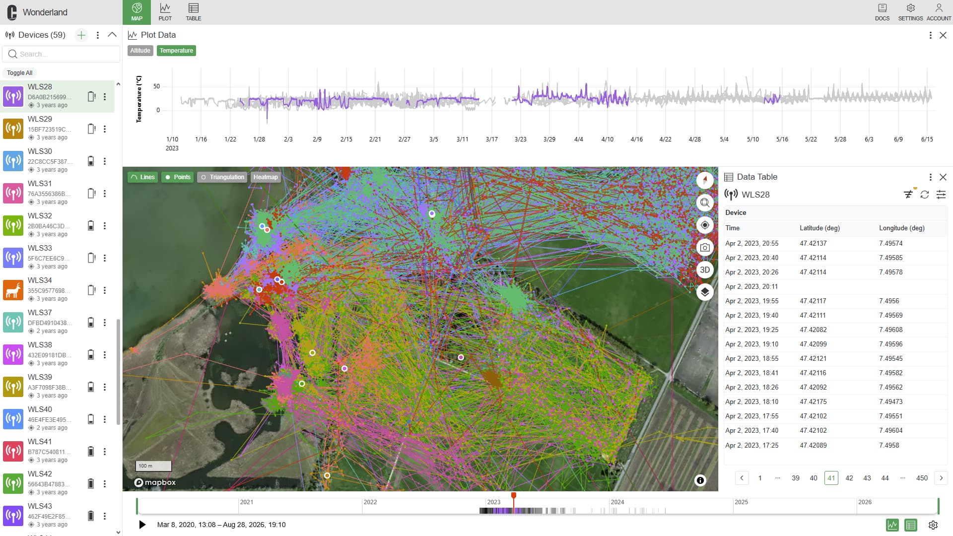

You can add the IoT Wonderland HTTP integration ( IoT Wonderland | The Things Stack for LoRaWAN ) to your TTN application, to visualise GPS data (and other) from a variety of tracking devices.
