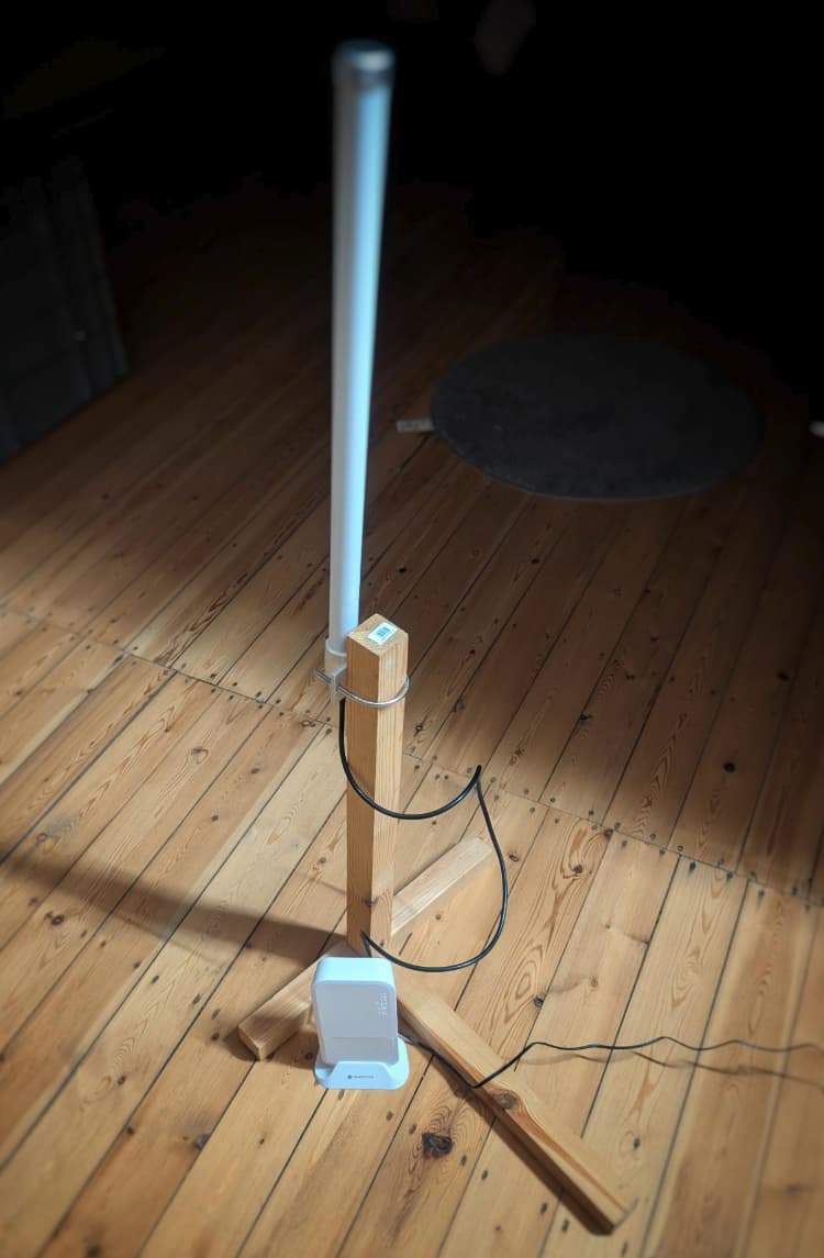

I finally received the stuff I ordered (despite the 3-day strike in Belgium). The wait was painful :grinning_face_with_smiling_eyes: So here it is: my new and very first LoRaWAN setup!
It’s powered by a Mikrotik WAP LR8g Kit and a Mikrotik Omni 868 Antenna.
Funny enough, the hardest part was simply getting the gateway to talk to my existing network :rofl:
But everything is up and running now, and the gateway already shows up on ttnmapper.org (The location is spoofed, I didn’t want to disclose my actual home). So far, so good!
Next steps:
• hook up a few end-nodes (temperature sensor, car-detection sensor, etc.)
• play around with the API
• integrate everything with Home Assistant (never tried LoRa with HA before — any tips are welcome!)
And yes… please be kind about the very improvised fortune antenna stand :sweat_smile:
It’s only a temporary indoor setup while I get familiar with the hardware. Once I’m done experimenting, I’ll move everything outside and get a proper stand probably something like this one or maybe mount it on a wall.
More updates soon!
Thank you for your feedback !

I was aware of the more affordable gateways on the market, but as a long-time fan of Mikrotik gear (and given the versatility of the wAP LR8g kit) the choice was an easy one for me.
I also liked the idea of pairing it with a proper antenna, and the Omni 868 looked like a solid pick with its 6.5 dBi gain.
