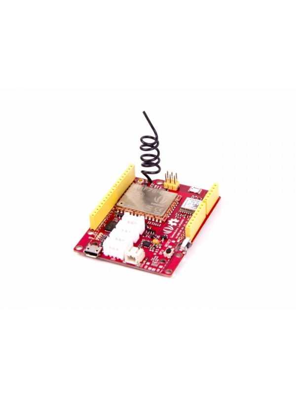

I found Devices that support dual frequency but i dont know if it can change automatically or just broadcasts on both frequencies at the same time. I guess no one travels across different regions in this community.

Yes, there is a dual frequency device, and you need two antennas really. That device is not enough for Worldwide operation.

Not in the way you think, though the manufacturer is being somewhat misleading.
Typically LoRa chips have distinct RF ports for a low band and a high band. But common LoRaWAN usage including TTN is on two different high bands depends on region; there isn’t a ready way for typical hardware to support that.
Not only is that manufacturer being a bit misleading, they aren’t even telling you which high band what you buy will have its high band networks tuned for.
It’s best to avoid buying from suppliers who give such hints that they don’t know what they are talking about.
