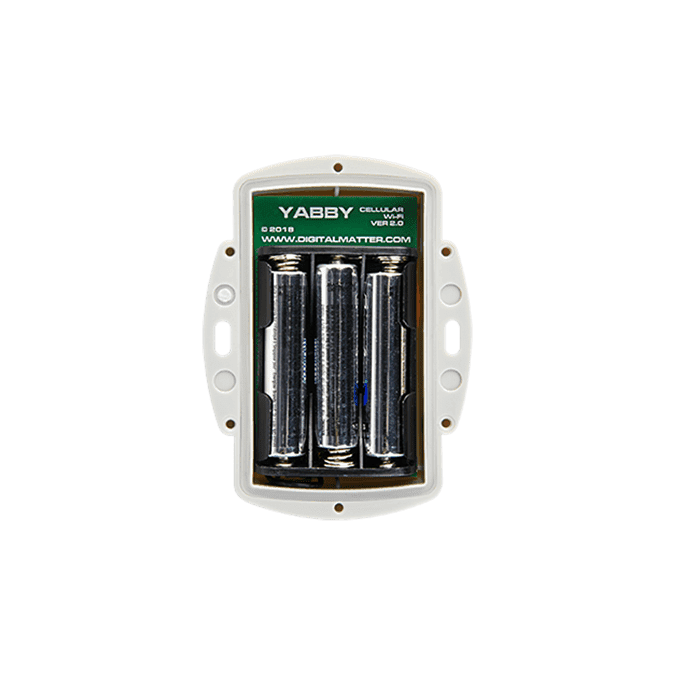

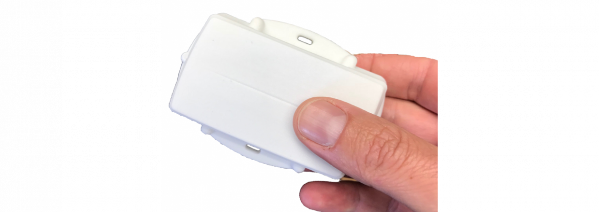

Hi @Slashbrackets, the smallest COTS GPS tracker device that I use is the DigitalMatter Yabby.
The manufacturers publish a very good Javascript decoder that works reliably on TTN. They are easy to configure over USB using a downloadable Windows PC utility. By default they uplink based on motion. I also configure some for per 15-mins uplinking.
Most of the volume of the device is taken up with 3x AAA batteries, not the electronics which are very small.
I guess that you could find smaller devices at the cost of battery life.

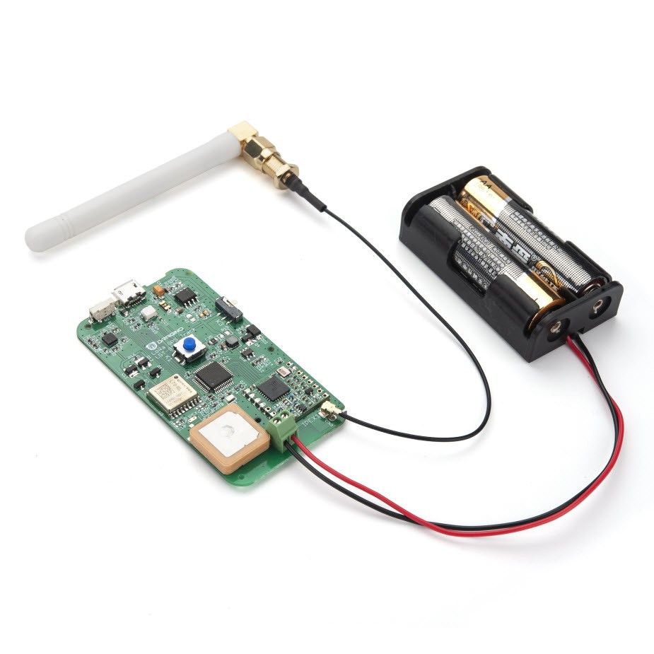

One of the best but still affordable GPS devices I’ve ever had my hands on so far is the Dragino LGT-92.
It’s available in two versions:
  1. Lithium-Ion Battery-powered + Case
  2. PCB-Version that can be powered by using AA Batteries (or any other)
The second version has all the features you need to turn this into an industrial LoRaWAN tracker that runs on batteries for month or even years (depending on the battery).
Here’s a good overview:
