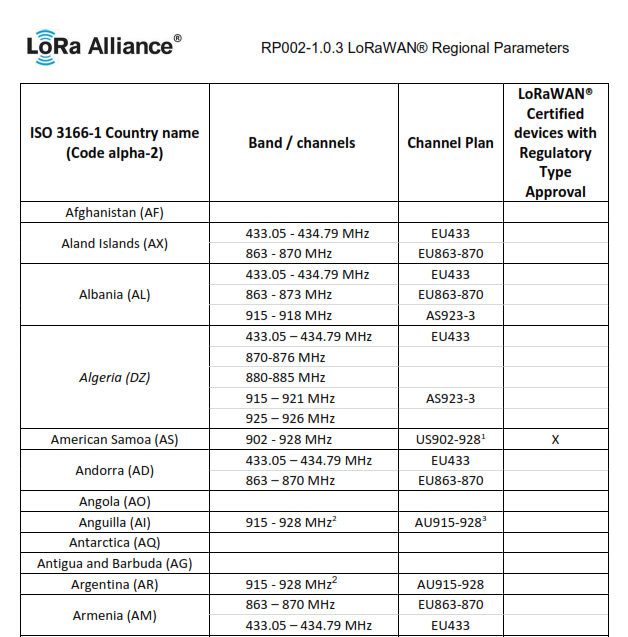

There is for instance no mention of LoRa or LoRaWAN in the guidance to the regulations for the UK. But the guidance does say how the radio spectrum can be used.
Its for you to do your own due diligence but this may be a help:
Note EU433 is quite uncommon in the context of TTN… AS923-3 on the other hand…

Algeria
