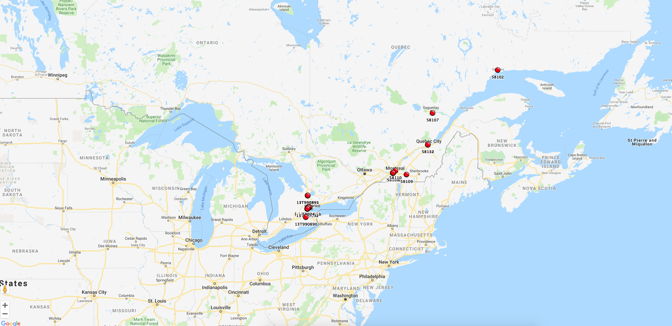

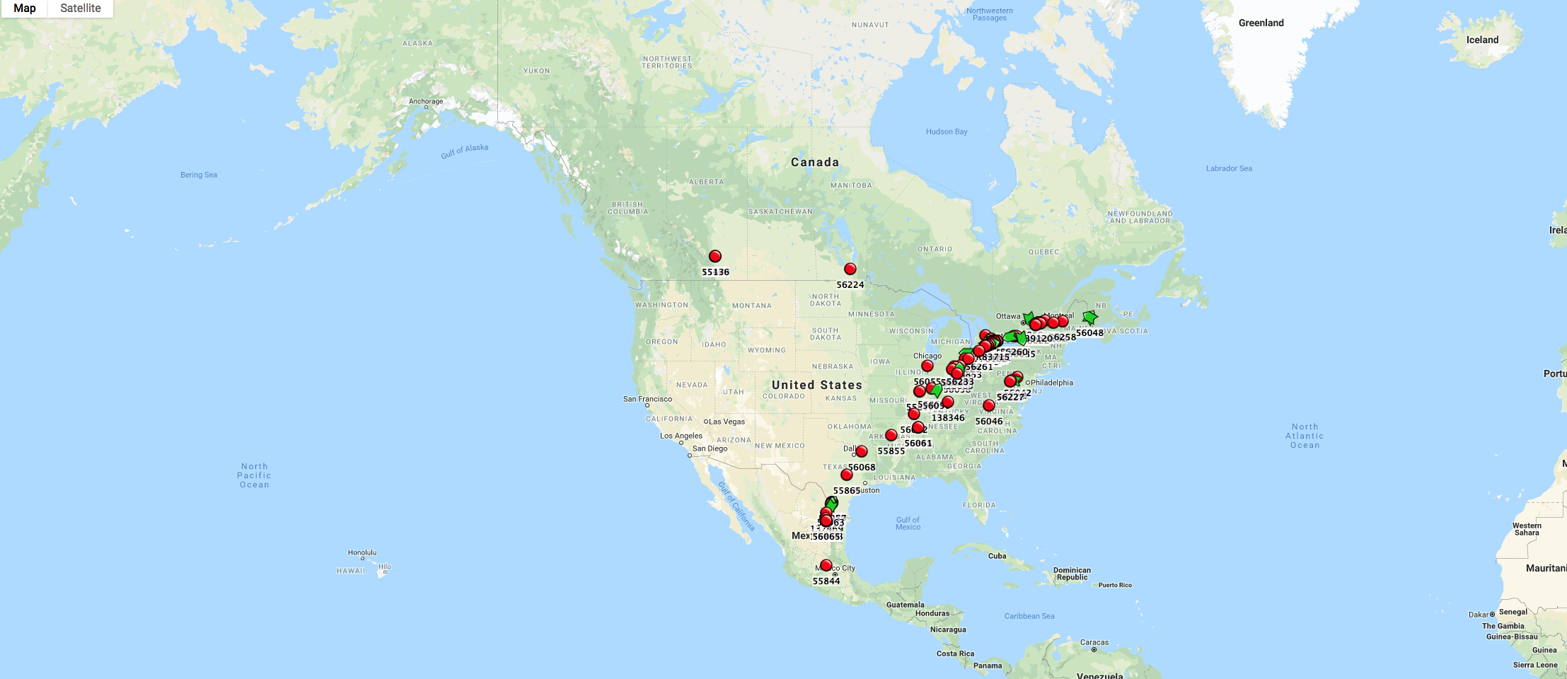

We use 3G trackers for buses, vehicles, trucks instead of LoRawan network.
We will have LoRa environmental sensors on the bus to measure temperature, humidity, air quality, UV light and upload the data 2-4 times daily.
Trailers with 3G trackers. We will eventually add LoRawan environment sensors which are âpeel and stickâ installed, collecting env data along their routes.
