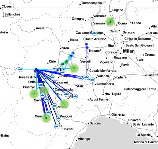

On the 1st august I was on a top of a mountain in Italy (1500 m altitude) and worked perfectly reaching gateways more than 100Km away ( switched on only for 1 hour to test it)

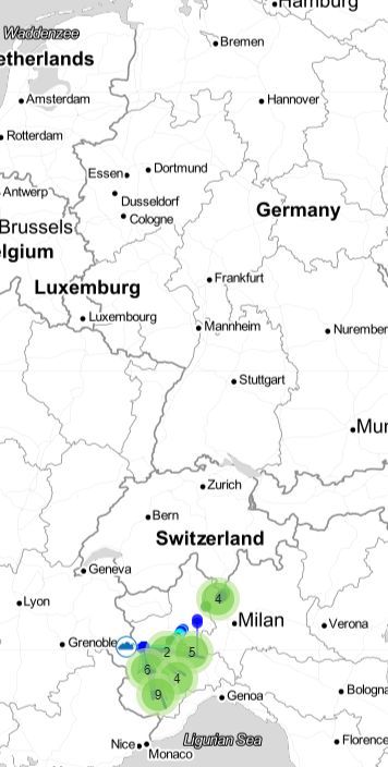

Then I placed it on the roof of the car and start the trip to Bremen ( Germany)
It starts to work, I reached some of the previovous gateways, but it stop to work after about 2 hours and did not even join my homebase gateway when arrived near Bremen.
(battery where still ok).
I was expecting to not see a gateway in the middle of the mountain, but I was expecting some points in Germany.image

Every 30 seconds, thats a lot ?
Easy to run into legal duty cycle restrictions or TTN fair access limits if you transmit so often.

As usual the problem is in front of the screen.
I made the calculation to cover the trip with SF7 and consumed airtime of 60ms. (and found a decimal error)
I was expecting to have 10 hours to cover the trip with SF7.
I have reviewd the data on TTN mapper and found the device was automatically switching from SF 9 up to SF11/12 most of the time…
Indipendently from the transmission rate programmed to use that give a budget for about 37 messages per day. Which I correctly got.
The times when the unit transmit and no GW was on sight (beeing in a tunnel or between building/mountain) of course were not counted.
