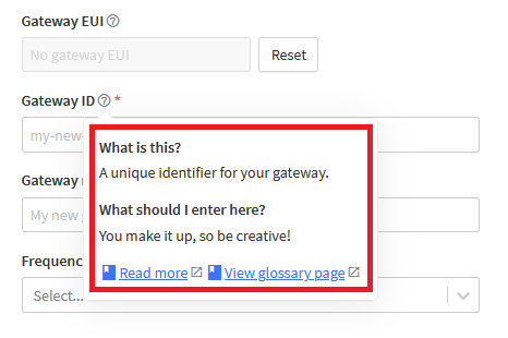

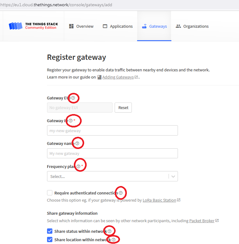

On the registration page there is advice/info and links to documentation - if users ignore not much you can do about it. In this case: (GW registration process):-
All key items have a query button.
In the case of GW ID it tells user
And provides helpfull links such as (Read More):

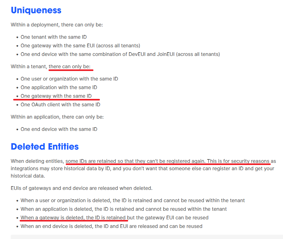

https://www.thethingsindustries.com/docs/reference/id-eui-constraints/
Where it tells more even saying wrt uniqueness and deleted entities:
The problem isnt stopping people deleting - potentially a necessary evil, but rather getting people to understand implictions and follow up especially when then re-registering

EUI & ID constraints
Its underlined in âredâ in my extract from the referenced document/section in my post aboveâŚ
