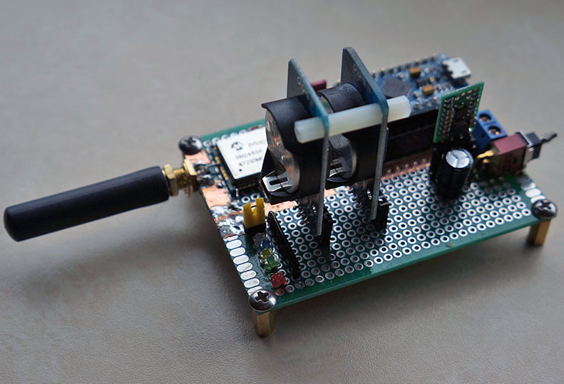

I used a second RTC for that (a dual timer RTC later) , generating an MCU interupt , on which the node transmits on a special ‘heartbeat port’
advantage is that you now know if its the node thats failing or the gw

old POC with 2 x DS3231
