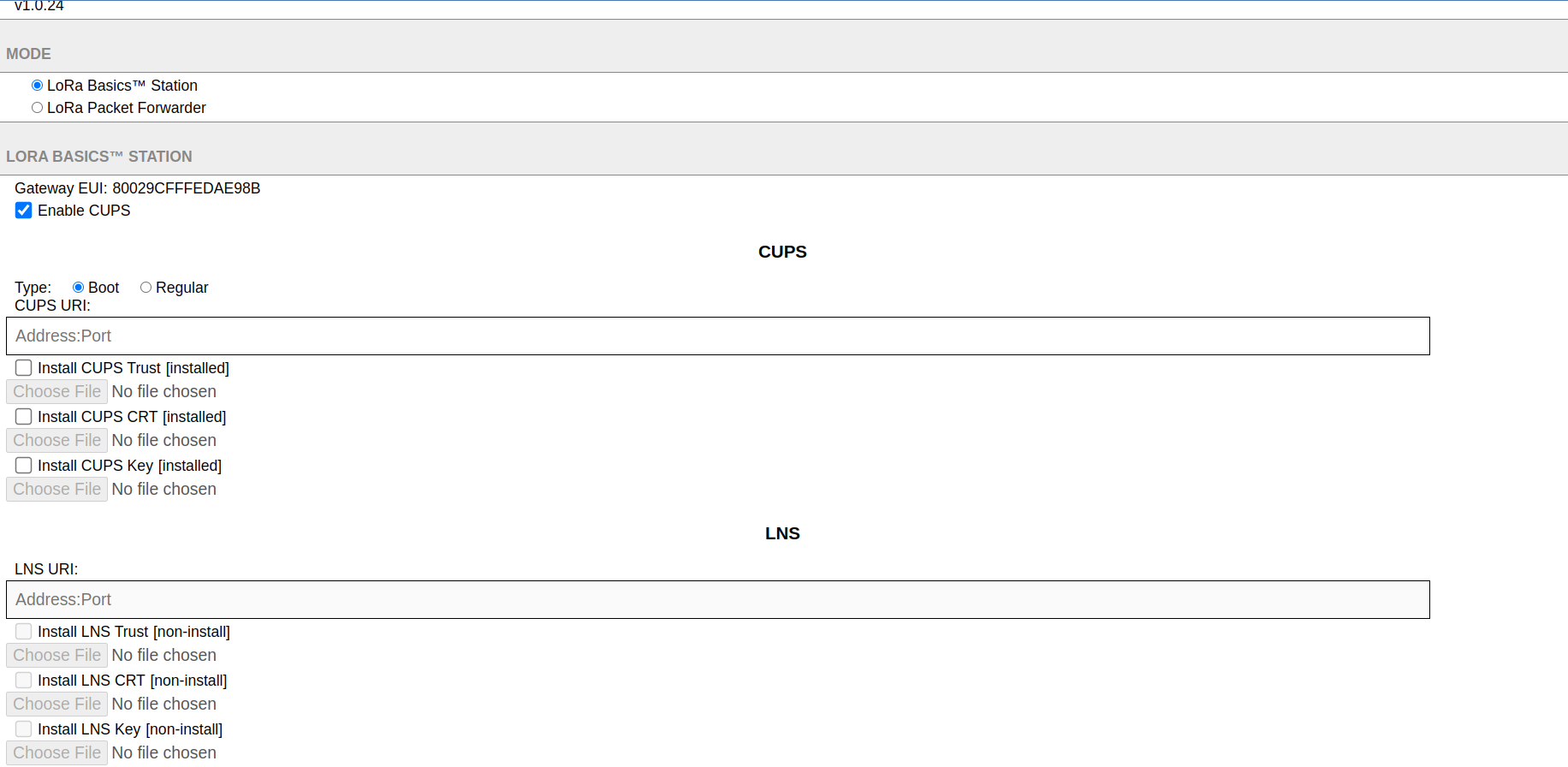

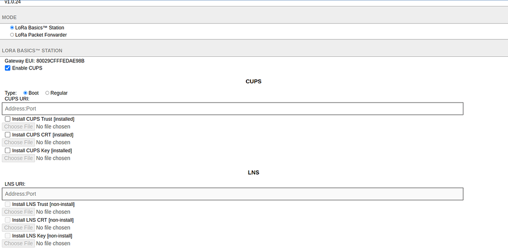

I have firmware v1.0.14 and found vicatcu’s post helpful…
  • I configured my gateway as a LoRa Basics Station, Enable CUPS, setting Type as Regular, I used the CUPS Trust certificate data vicatcu obtained from Browan because the Mozilla pem file failed
  • In v1.0.14, I am unable to configure LNS params when I Enable CUPS. As far as I can tell, the gateway obtains the LNS params I have configured from the CUPS server (please correct me if wrong)
Hope this helps someone.

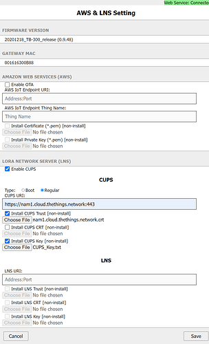

I am trying to commission a TBMH110 with no luck so far. I could use some help.
Hardware
Model: TBMH110
(92) 80029CFFFEDAEADE
(21) TBMH110915000121
FCC ID: 2AAS9TBMH110
Firmware: 20201218_TB-300_release (0.9.48)
  • The Setup GUI on the gateway has no option to select “Basics station” or “Packet forwarder.” I am proceeding as for a Basics station.
  • There is EUI label on the gateway; I am assuming it is (92) value listed next to the model number
  • I have configured CUPS and LNS API keys as described in Configuration and Update Server (CUPS)
  • It’s not clear to me which certificates are required in the “CUPS Trust” and “CUPS CRT” inputs. I have tried using the single server cert @vicatcu posted above, and the multi-cert PEM described in Minimal Certificate List for Common Installations
Any hints?
It looks like you have a version of the product (firmware) that is designed specifically to provision with AWS (Amazon Web Services)… Unfortunately, I don’t know how to do that, or I would help. I would suggest contacting Browan support to see if they can offer a guidance document.

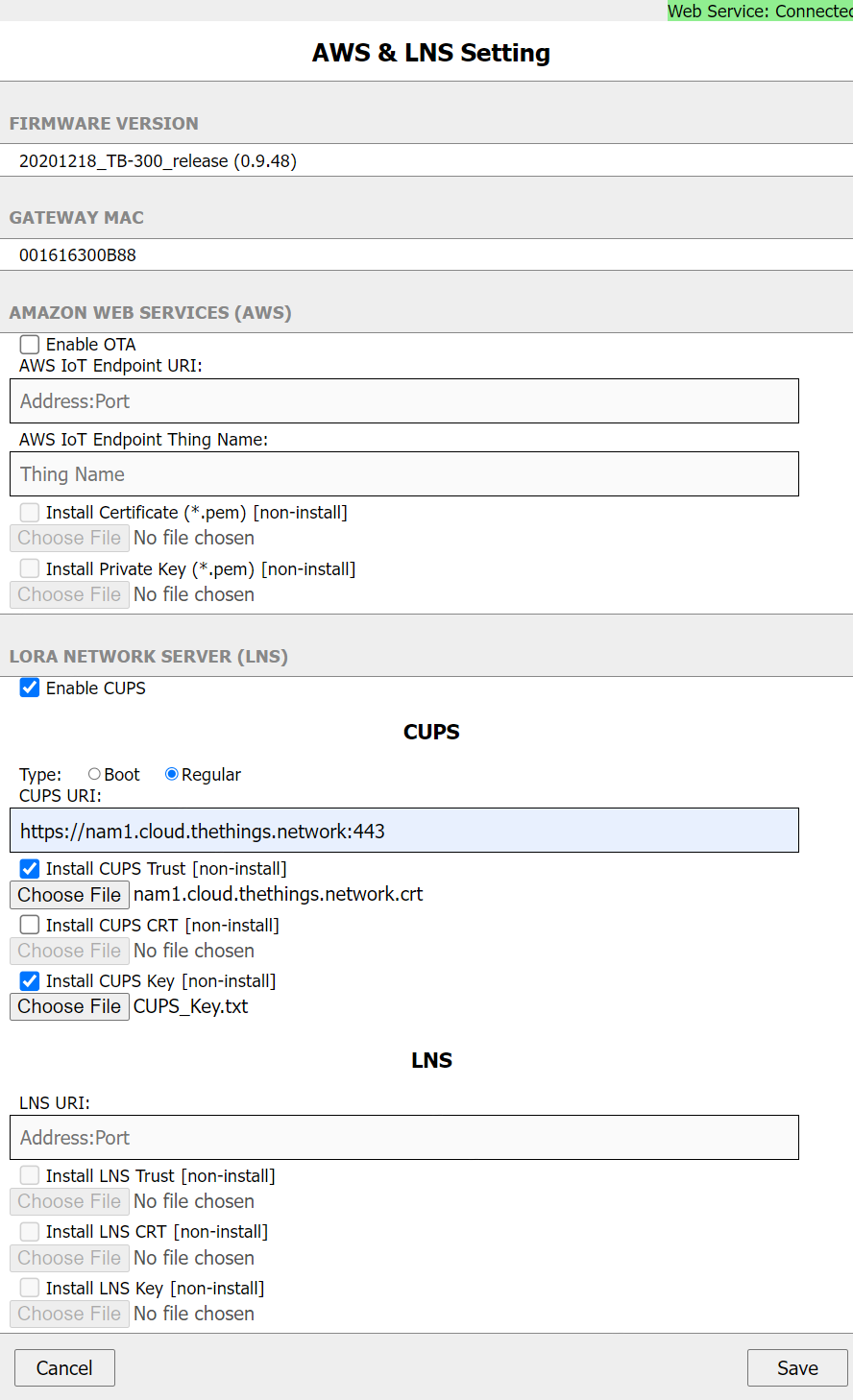

Did you use Boot or Regular to the CUPS type?
I tried multiple times, but my minihub is still blinking green and I don’t see any connection attempt on TTN gateway dashboard.
I double check the correct EUI, uploaded the isrgrootx1.pem to the install CUPS Trust and the TTN created CUPS key file to the Install CUPS Key.
the CUPS URI in my case is https://nam1.cloud.thethings.network:443 as on my other gateways.
The minihub accepts all the settings but no traffic to TTN is seen and still flashing green on the minihub…
It would be nice to have at least a log page on the minihub to see what is happening.
