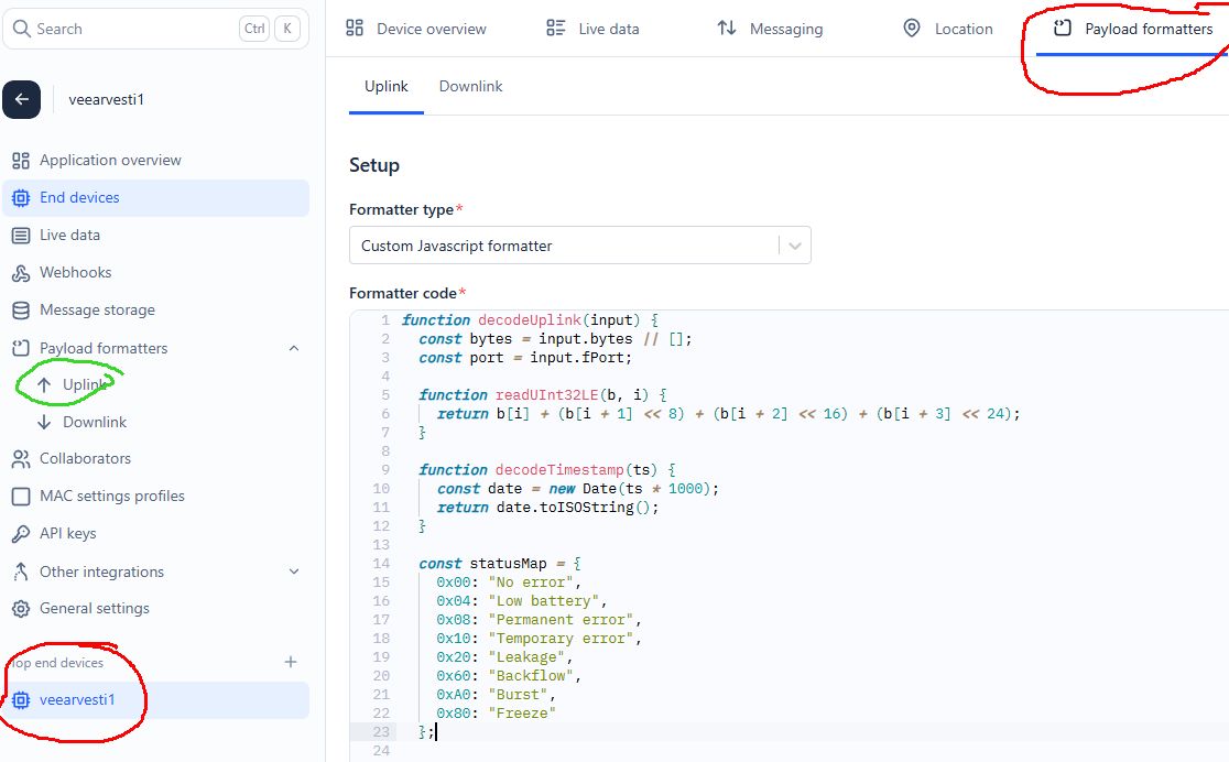

working decoder:
function decodeUplink(input) {
  const bytes = input.bytes || [];
  const port = input.fPort;
  function readUInt32LE(b, i) {
    return b[i] + (b[i + 1] << 8) + (b[i + 2] << 16) + (b[i + 3] << 24);
  function decodeTimestamp(ts) {
    const date = new Date(ts * 1000);
    return date.toISOString();
  const statusMap = {
    0x00: "No error",
    0x04: "Low battery",
    0x08: "Permanent error",
    0x10: "Temporary error",
    0x20: "Leakage",
    0x60: "Backflow",
    0xA0: "Burst",
    0x80: "Freeze"
  const data = {};
  if (port === 100 && bytes.length === 9) {
    const currentTs = readUInt32LE(bytes, 0);
    data.current_datetime = decodeTimestamp(currentTs);
    const status = bytes[4];
    data.status_code = "0x" + status.toString(16).padStart(2, '0');
    data.status_description = statusMap[status] || "Unknown";
    const currentVolume = readUInt32LE(bytes, 5);
    data.current_volume_liters = currentVolume;
    data.current_volume_m3 = currentVolume / 1000;
  } else {
    data.error = `Unsupported port ${port} or length ${bytes.length}`;
  return { data };

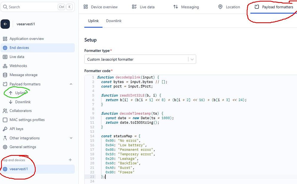

a my bad , i inserted payload formatter decoder in the left menu with green, but had to insert to device
with red
Now its working fine and decoding.
