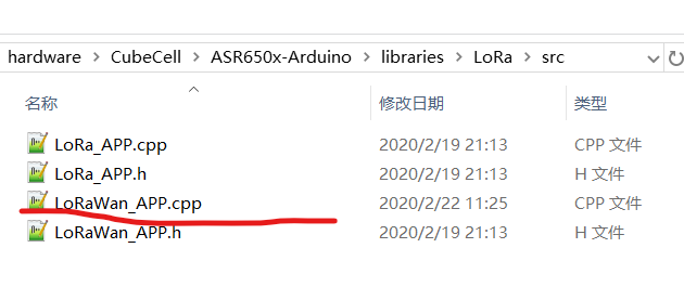

@Paul_Stewart
Maybe this operation make sense to you:

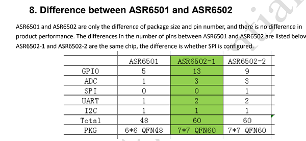

Questions:
  • What is the difference between ASR6501 and ASR6502?
  • What Heltec products will use the ASR6502?
Full PDF is there.
EByte sells ASR6501 (sample) modules as low as 2+ USD per one piece delivered (depending on frequency band).
Since ASR6501 has only 1 UART access available - this SiP has little or no use for my purpose.

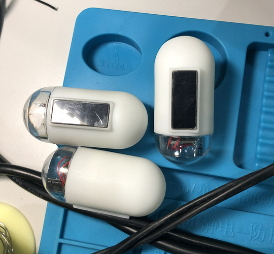

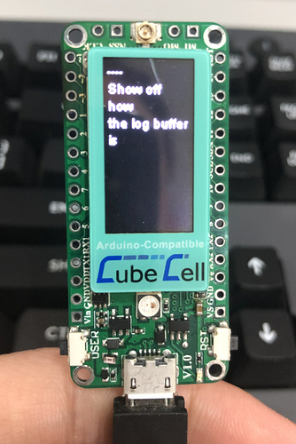

the new CubeCell products with the ASR6502 will be ready next week
have a look here:
http://community.heltec.cn/t/some-new-cubecell-products/1372
![72ed3f1dd0c012af1240dc9b691d93227ab4260a_2_334x500|334x500]
28fb6ae35e025f923cde0c6f9763cafe2ef62f8c_2_540x500
