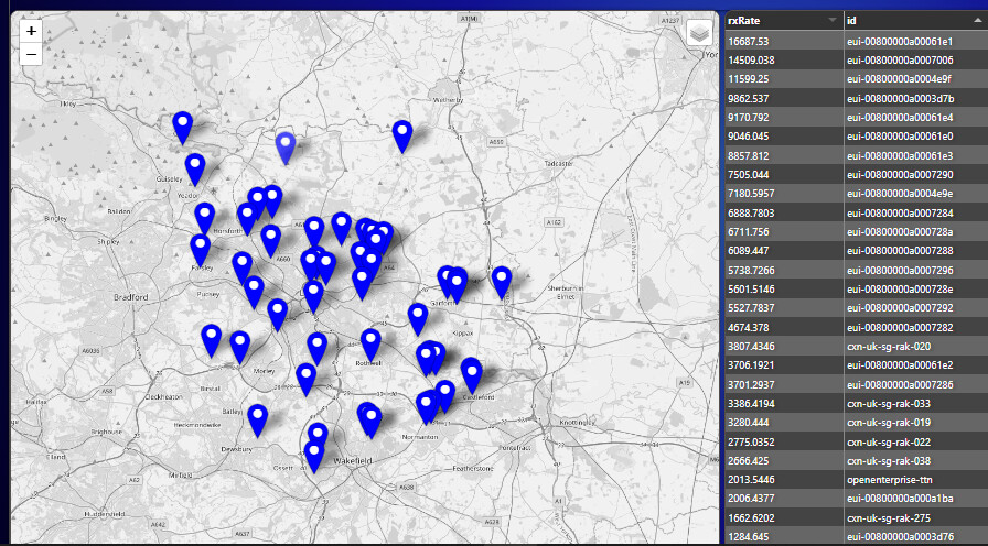

These are the gateways in Leeds.
There are a few gateways well over 5000 uplinks, this is in part due to a large scale TTI deployment.
