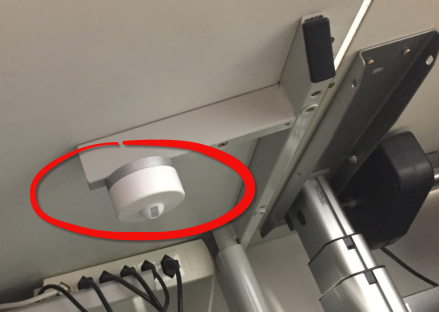

I was reading this reverse engineering post about a LoRaWAN occupancy sensor today:
Although I disagree with much of its tone (eg. “who needs more than one gateway!!1!!”, “never use an unprotected UART!”) I was interested to see how the author hijacked a device on TTN once they had extracted the AppKey. I have tried to recreate this but have been unable to divert traffic from a TTN Button into a new app with duplicate AppEUI and a DevEUI with the same AppKey as the old app. The device always joins the old app.

Some really good points are made particularly in regards to physical security such as tamper protection and not leaving EUI stickers on deployed devices.
Going from device hijacking to data breaches is a bit of a stretch. Social engineering in order to access applications is not just an IoT issue. And if devices are hijacked then that data is not much use anyway.
In regards to privacy, sensors under set desks is a bit on the nose, but there are reasonable use cases for use in meeting rooms and in hot desking situations where individuals are not identified (i.e. to get efficient usage from shared resources).
