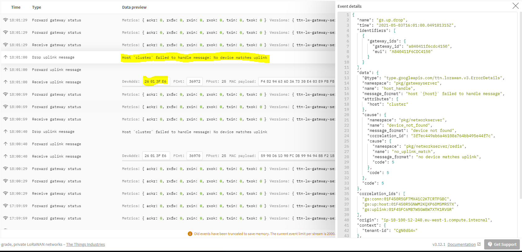

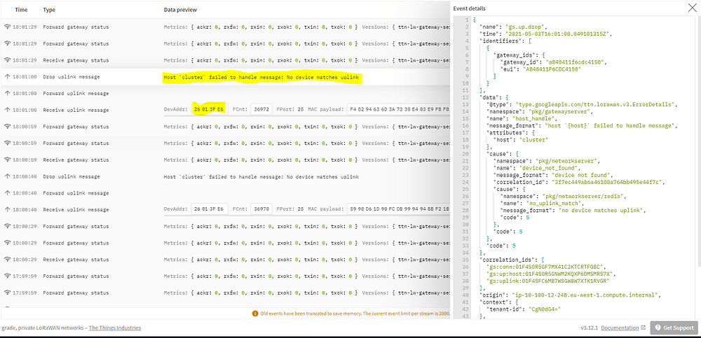

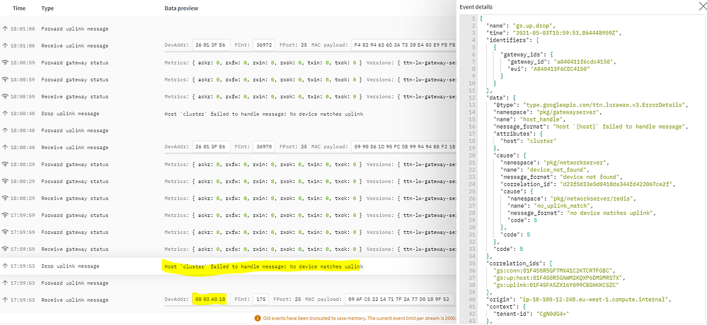

I read some topics already regarding this issue, but i didn’t find a solution or a workaround for the time being. The situation is the following:
I had a working setup in TTN v2 with sensors and gateways configured in v2. Now, i added the same gateway to TTN v3 and i created a new application for the same sensor, also in TTN v3.
When i try push the data throught the v3 gateway, i have 2 problems:
  1. the v2 sensor uplink is not handled in the v2 application anymore
  2. the v3 sensor is also not handled by the v3 application:
>   "name": "gs.up.drop",
>   "time": "2021-05-03T15:59:53.864448959Z",
>   "identifiers": [
>       "gateway_ids": {
>         "gateway_id": "a840411f6cdc4150",
>         "eui": "A840411F6CDC4150"
>   "data": {
>     "@type": "type.googleapis.com/ttn.lorawan.v3.ErrorDetails",
>     "namespace": "pkg/gatewayserver",
>     "name": "host_handle",
>     "message_format": "host `{host}` failed to handle message",
>     "attributes": {
>       "host": "cluster"
>     "cause": {
>       "namespace": "pkg/networkserver",
>       "name": "device_not_found",
>       "message_format": "device not found",
>       "correlation_id": "d23f5d33e5d0418da344fd422067ce2f",
>       "cause": {
>         "namespace": "pkg/networkserver/redis",
>         "name": "no_uplink_match",
>         "message_format": "no device matches uplink",
>         "code": 5
>       "code": 5
>     "code": 5
>   "correlation_ids": [
>     "gs:conn:01F4S0R5GF7MX41C2KTCRTFGBC",
>     "gs:up:host:01F4S0R5GNWM2KQXP6DMSMRS7X",
>     "gs:uplink:01F4SFA5ZX16Y099CBGHKKCSZC"
>   "origin": "ip-10-100-12-248.eu-west-1.compute.internal",
>   "context": {
>     "tenant-id": "CgN0dG4="
>   "visibility": {
>     "rights": [
>       "RIGHT_GATEWAY_TRAFFIC_READ"
>   "unique_id": "01F4SFA608CE22V3BH3G3F921C"
Now, what can be an explanation for this? The gateway is not forwarding the proper uplink json structure as documented here: https://www.thethingsindustries.com/docs/the-things-stack/concepts/data-formats/ ? Something else?
And what can be a workaround?
  1. keep my gateway & sensor in TTN v2? But what if the cluster shuts down?
  2. Wait for new FW on the gateway? I already reached out to Dragino.
  3. wait for TTN to handle these uplink json just like they did in TTN v2?
  4. Something else?
Thanks already a lot in advance for your input!
Kind regards
Gus

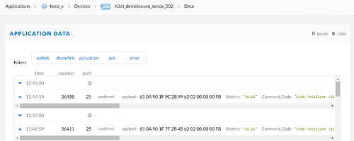

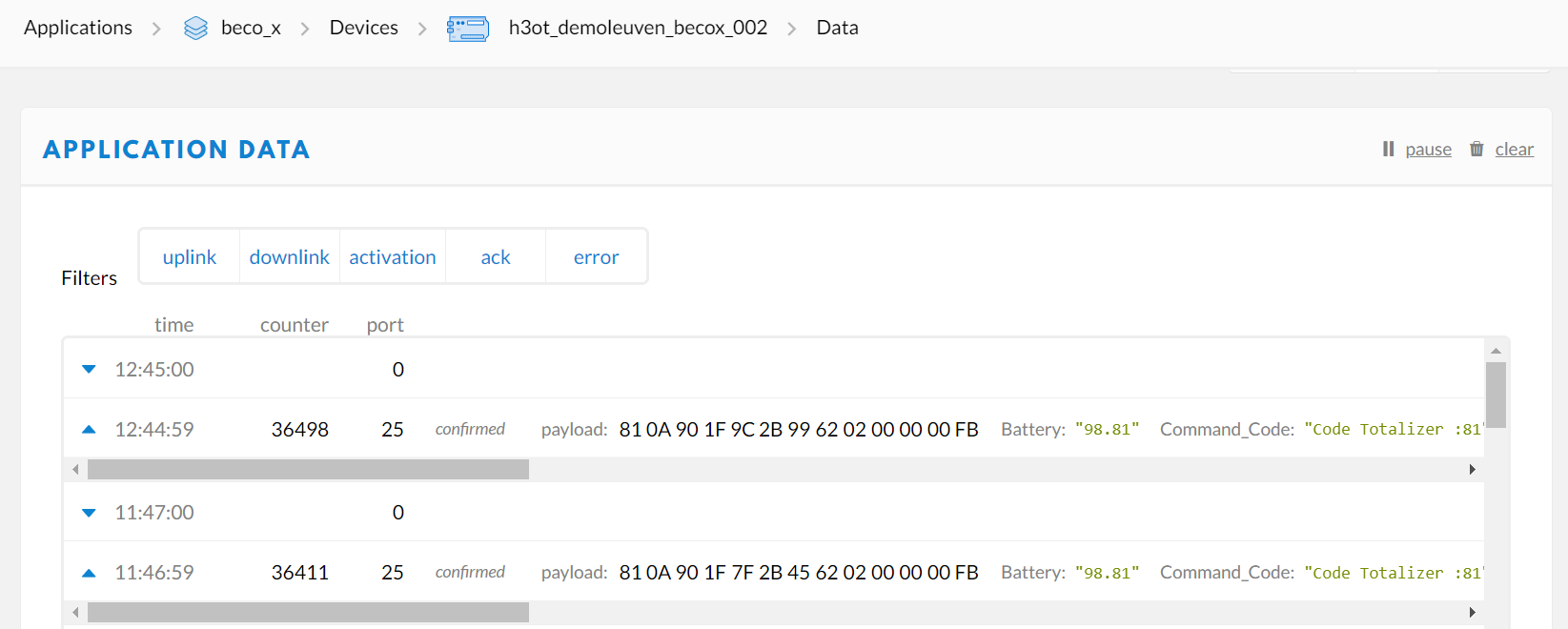

This is a screen shot of the v3 console so it’s not showing the v2 sensor uplink not being handled by v2 application. It’s just showing a non-matching uplink in the v3 console.
It is a TTN v2 DevAddr which would need entering in to the v3 setup if that is your device and it’s on ABP.
That’s not a TTN DevAddr so expected not to match.
I don’t think any workaround is needed - many of us now have devices on both v2 & v3 with gateways on both and it’s routing fine.
What is your device?
Did you put new keys in to your device?
How is the device configured and if it’s on ABP, what is its DevAddr?
Did you tell your gateway to point to the new v3 address?
Which Dragino gateway model do you have?
What firmware is it running?

There is no data coming in anymore on the v2 application, so not really sure what you want to see? Last update was from this afternoon.
How do i add the DevAddr in the v3 setup?

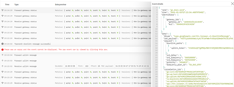

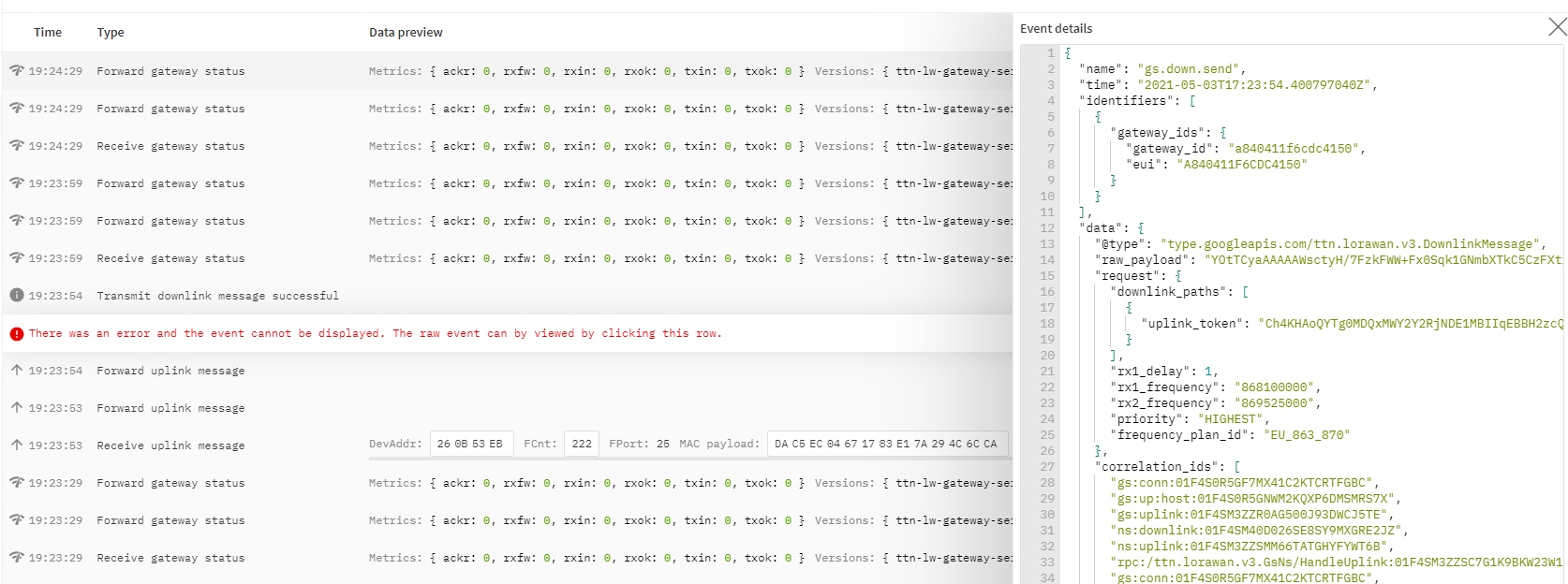

For the new v3 sensor, i created a new devaddr, nwkskey & appskey and put it in the sensor, and now the sensor is indeed seen ONCE. But there is a different error:
  "name": "gs.down.send",
  "time": "2021-05-03T17:23:54.400797040Z",
  "identifiers": [
      "gateway_ids": {
  "data": {
    "@type": "type.googleapis.com/ttn.lorawan.v3.DownlinkMessage",
    "raw_payload": "YOtTCyaAAAAAWsctyH/7FzkFWW+Fx0Sqk1GNmbXTkC5CzFXtrLtK53I8G1Q3uJRz7KSGXRAq37w=",
    "request": {
      "downlink_paths": [
          "uplink_token": "Ch4KHAoQYTg0MDQxMWY2Y2RjNDE1MBIIqEBBH2zcQVAQw769zgMaDAip48CEBhDQ4MXRAyC4u7CQnY0F"
      "rx1_delay": 1,
      "rx1_frequency": "868100000",
      "rx2_frequency": "869525000",
      "priority": "HIGHEST",
      "frequency_plan_id": "EU_863_870"
      "gs:uplink:01F4SM3ZZR0AG500J93DWCJ5TE",
      "ns:downlink:01F4SM40D026SE8SY9MXGRE2JZ",
      "ns:uplink:01F4SM3ZZSMM66TATGHYFYWT6B",
      "rpc:/ttn.lorawan.v3.GsNs/HandleUplink:01F4SM3ZZSC7G1K9BKW23W1FBG",
      "rpc:/ttn.lorawan.v3.NsGs/ScheduleDownlink:01F4SM40D0CZK0XVM46N07NQ0M"
  "context": {
  "visibility": {
    "rights": [
  "unique_id": "01F4SM40D0DFR2C7E2XCS77HG5"
Even though data should come in every 2 minutes, that’s currently not happening. The sensor is only seen once.

You made a statement about the v2 console but provided a picture of the v3 console …
That’s not a gateway, that’s what we call a Dual Channel Packet Forwarder, the big and equally illegitimate brother of the Single Channel Packet Forwarder. These are detrimental to the network, which strangely enough, you’ve just discovered and as they are so disruptive, we ask people to disconnect them immediately.
Your device expects to transmit on any of 8 channels to a gateway that can listen for activity on 8 channels & the associated spreading factors simultaneously. A DCPF can only hear two channels and it’s ability to operate CAD makes it’s ability to listen on those two channels across all the SF’s is questionable.
So, turn off the LG02, return to vendor and await your LG308.
As for the error message, a quick forum search will reveal the information you need.
