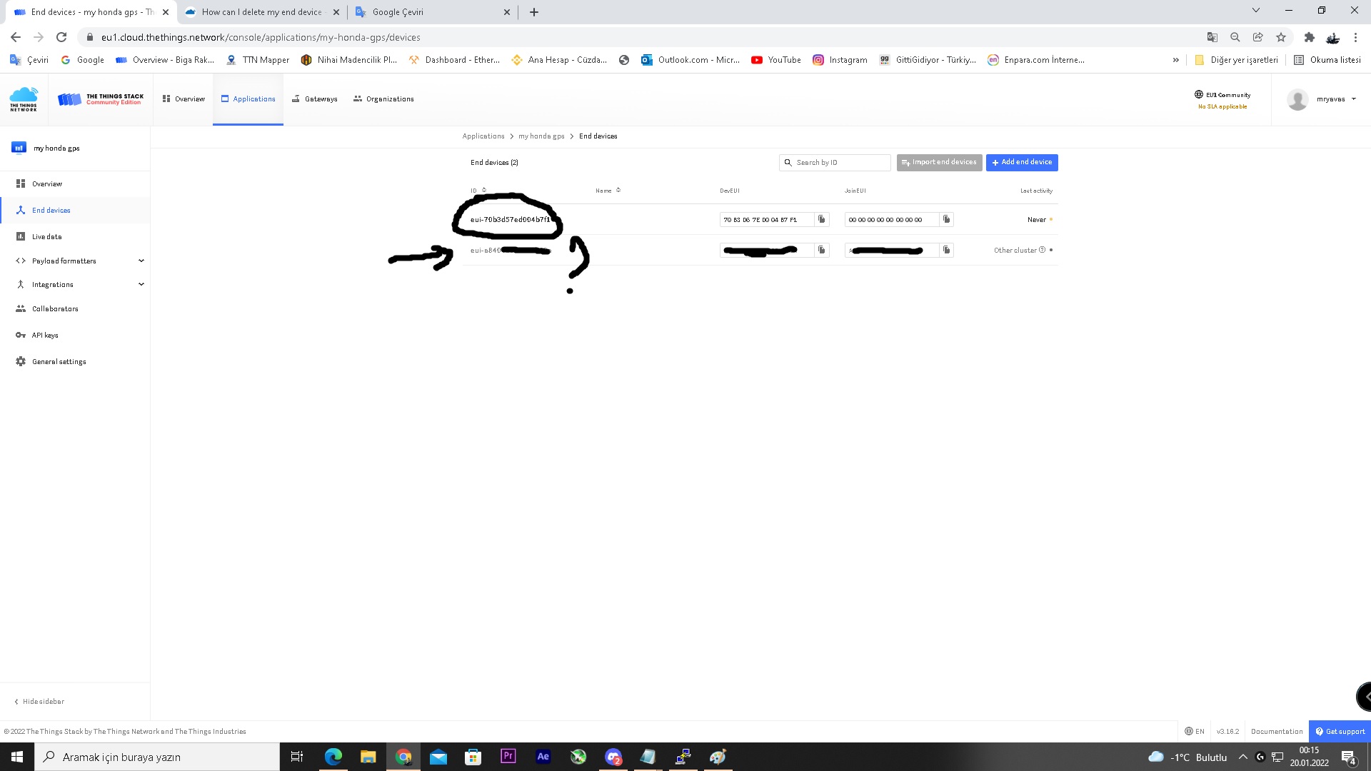

I can’t choose because it’s faded
devi
devic
Not sure what you are trying to show - the ‘red’ text isnt bright full hue but lower contrast and I can see it above (4 o’clock relative to your arrow) - have you tried it? click/select that (does mouse pointer change from pointer to grab hand when you hover over it?)

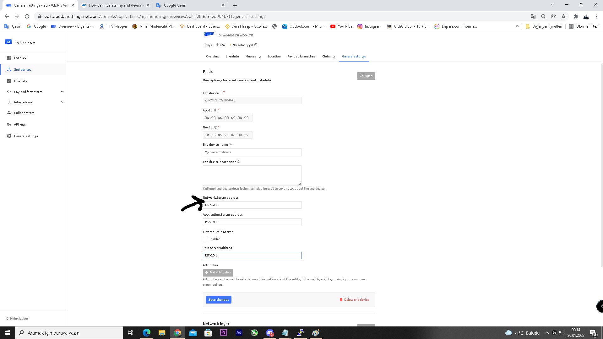

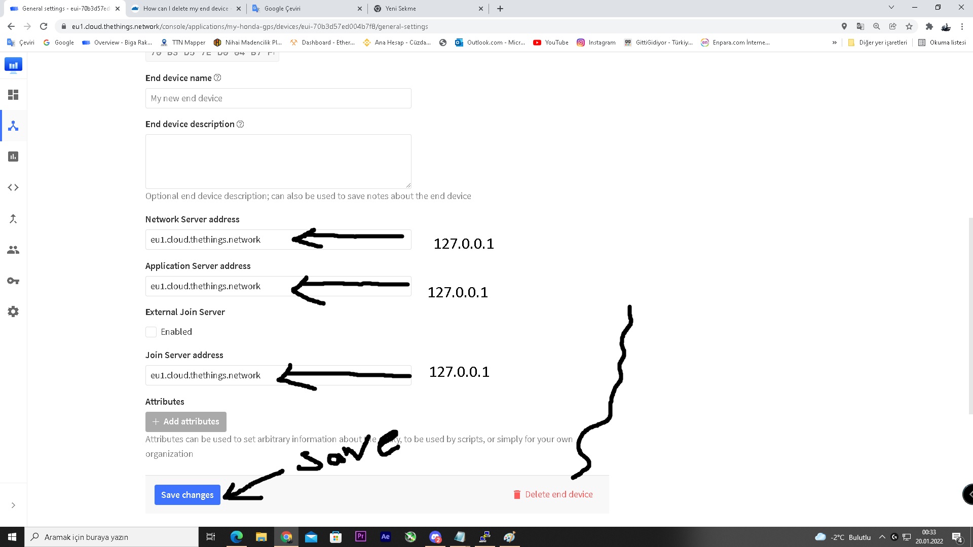

in general settings. I wrote 127.0.0.1 to try something. then I can’t click on the device, it’s grayed out. I hope I can explain.
Hi jeff. Add a device and save the network server address as 127.0.0.1. Then try to delete it and see if you can delete it.
Sorry no time for that - you did it (twice!) so no point me cluttering my console views too! :wink: Have you tried editing the address info in your screenshot above and using “save” to save the edit or is that not possible? Also did you try what I asked and hovered over/clicked the red “Delete end device” icon/text - what happened?

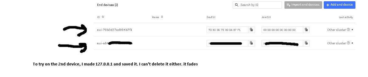

save is not possible. As I said, since I wrote 127.0.0.1 to the server address, the device does not delete. On the console, the device is dimmed, it says other cluster. tank you jeff .
In that case I suggest you post in the TTN Slack #support channel with link to this thread and ask if TTI core team can assist as it is likley beyond the scope of the Forum constributors and volunteers - maybe there is a command line interface option to delete that target end device - @descartes Nick any suggestions if this cant be done direct from console?
There are CLI commands for deleting but I’m loathed to setup a test for this instance. No reason it shouldn’t work.
