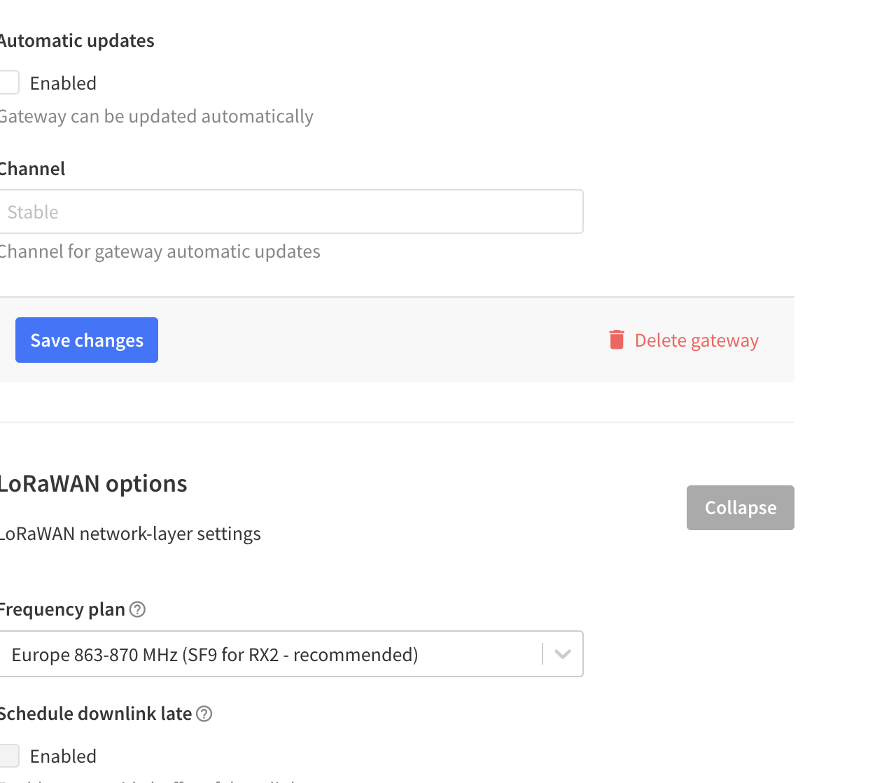

However my gateway is saw from V2 but not from V3.
I wonder if I registered it correctly to V3.

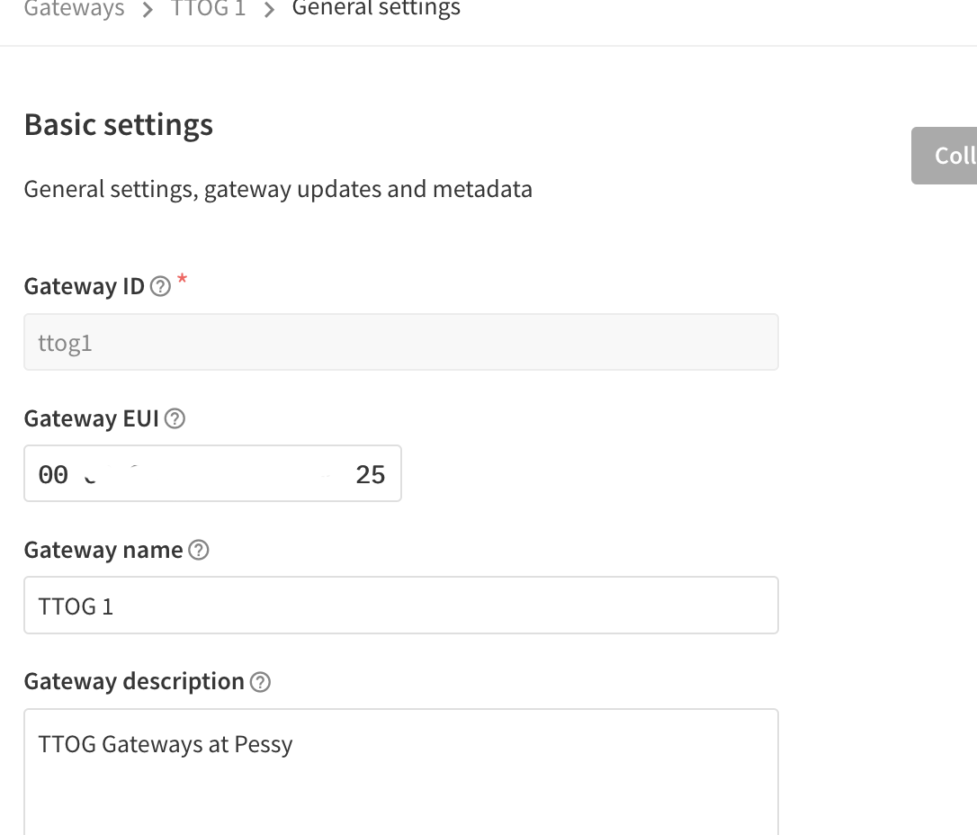

Because when I look at my Gateway from V2, the gateway ID is eui-1234567812345678
in V3 I enter ttog1 as gateway ID and in the EUI field, I saved 1234567812345678
Should I create a new gateway in V3, with the Gateway ID eui-12234567812345678?
Then what should I save in the EUI field?
I am a bit confused because here it show what I did
You can put anything you like in the ID field.
You put the EUI in the EUI field.
You also change your gateway to point to the v3 server for your region!!

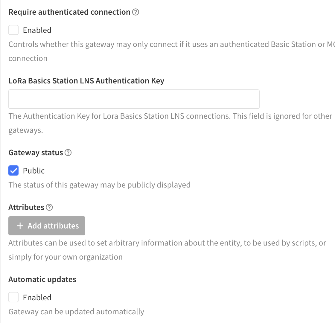

OK, then why my gateway is not seen in V3? I may have did some things wrong.
In fact, in the V3 console, the gateway is not connected.
Or should I wait for first message? But usually, the gateway is seen as soon as I power it

Have you changed the configuration on the gateway so it is sending to the v3 server like I asked above?

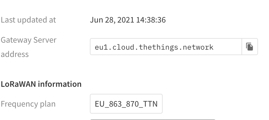

In my Gateway console the TTN server is: eu1.cloud.thethings.network
But I have been loged into the gateway, and I controlled the configuration following that page
The page provide you a link to the router address for the region
Into my TTOG gateway, I have not saved: router.eu.thethings.network but ttn.opennetworkinfrastructure.org but I guess, it does not matter, isn’t?
No, no you don’t, because you can NEVER go back - look at the forum discussion where we countless say this.
How will it know where to send the uplinks to the new version of the TTN??
You HAVE to change the gateway server address ON THE GATEWAY to the one shown on the console.
On the V3 gateway page there is a button to download global_conf.json. In that file search for “server_address” and use that value on your gateway. If you don’t it will not work.
Aïe, I did it
Ok, then my mistake is here. Initially I have ttn.opennetworkinfrastructure.org
I am sorry but I am confused because here It show
router.eu.thethings.network EU 433 and EU 863-870’ for Europe or
ttn.opennetworkinfrastructure.org for Switzerland.
Then I have to saved ‘eu1.cloud.thethings.network’ ???

I never understand why people take unilateral action after asking for advice.
Those are the instruction to v2.
I gave you the link to v3 documentation which yielded the correct address of ‘eu1.cloud.thethings.network’.
Can you not hear me screaming at the screen from here?? :wink:
Hello
OK that work now. My gateway is now connect.
