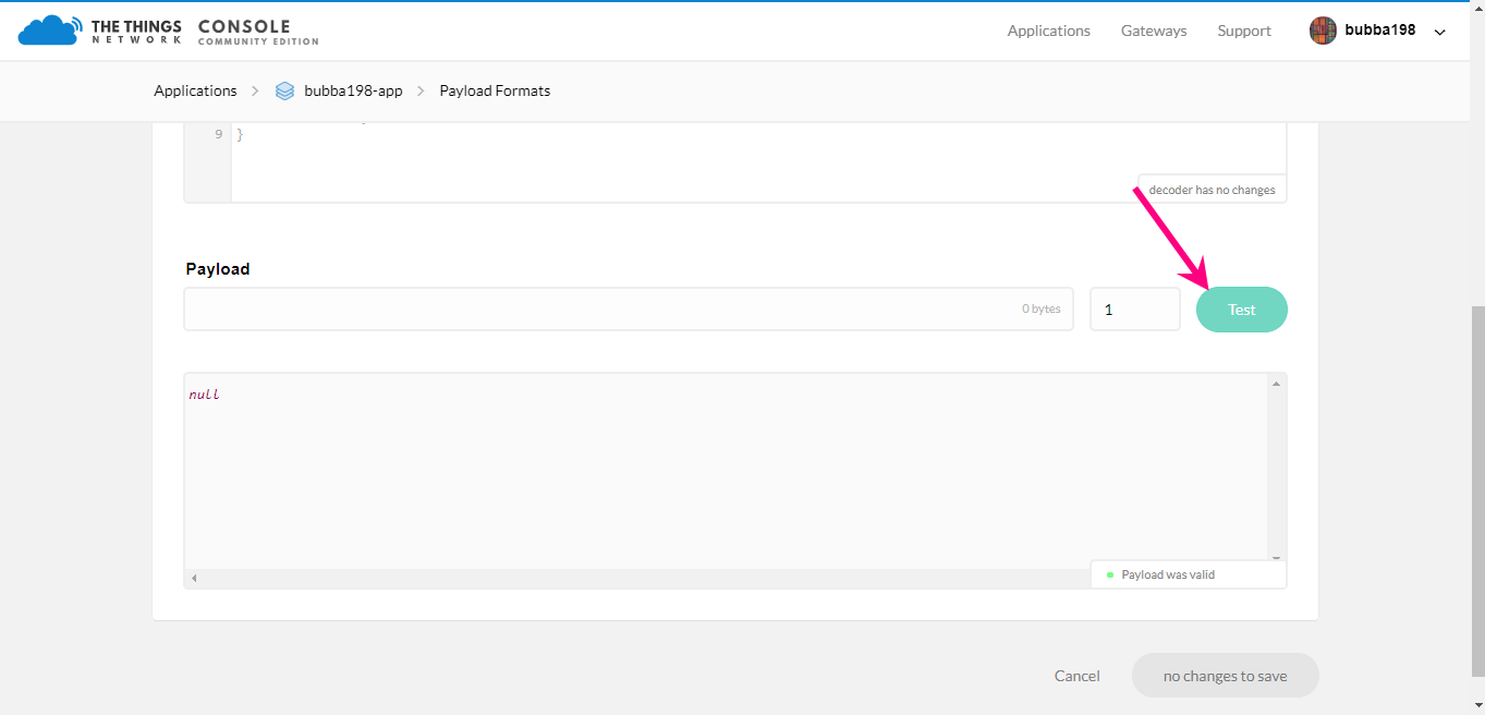

I have a very simple HTTP integration setup but I struggle how to initiate a test (I don’t have a device registered for that app)
The only test I found is below but does not push data via my integration
The test you found is only to validate the JavaScript code of the application’s Decoder, and its results are only displayed, not handled in any way. Uplinks are sent through a device, not the application.

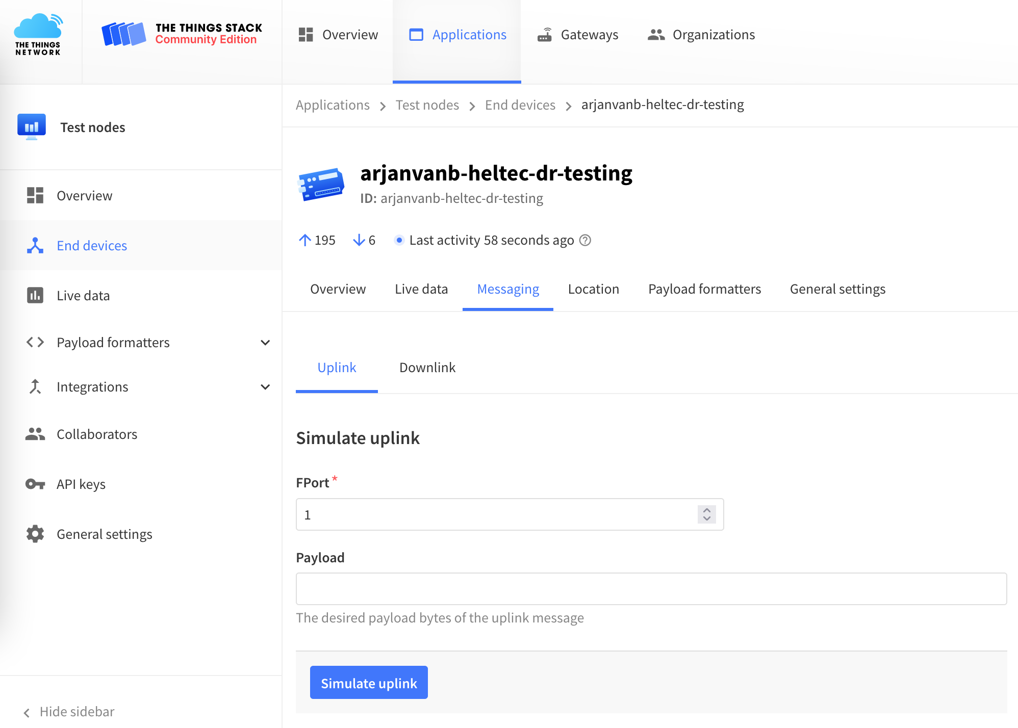

Hello Arjan, is this facility (uplink simulation) also integrated in the new console? Where can I find it? Thanks…
Sure, it’s still in Devices, now in Messaging:
V3 Simulate Uplink
Aha, I found it. Thanks and regards…
