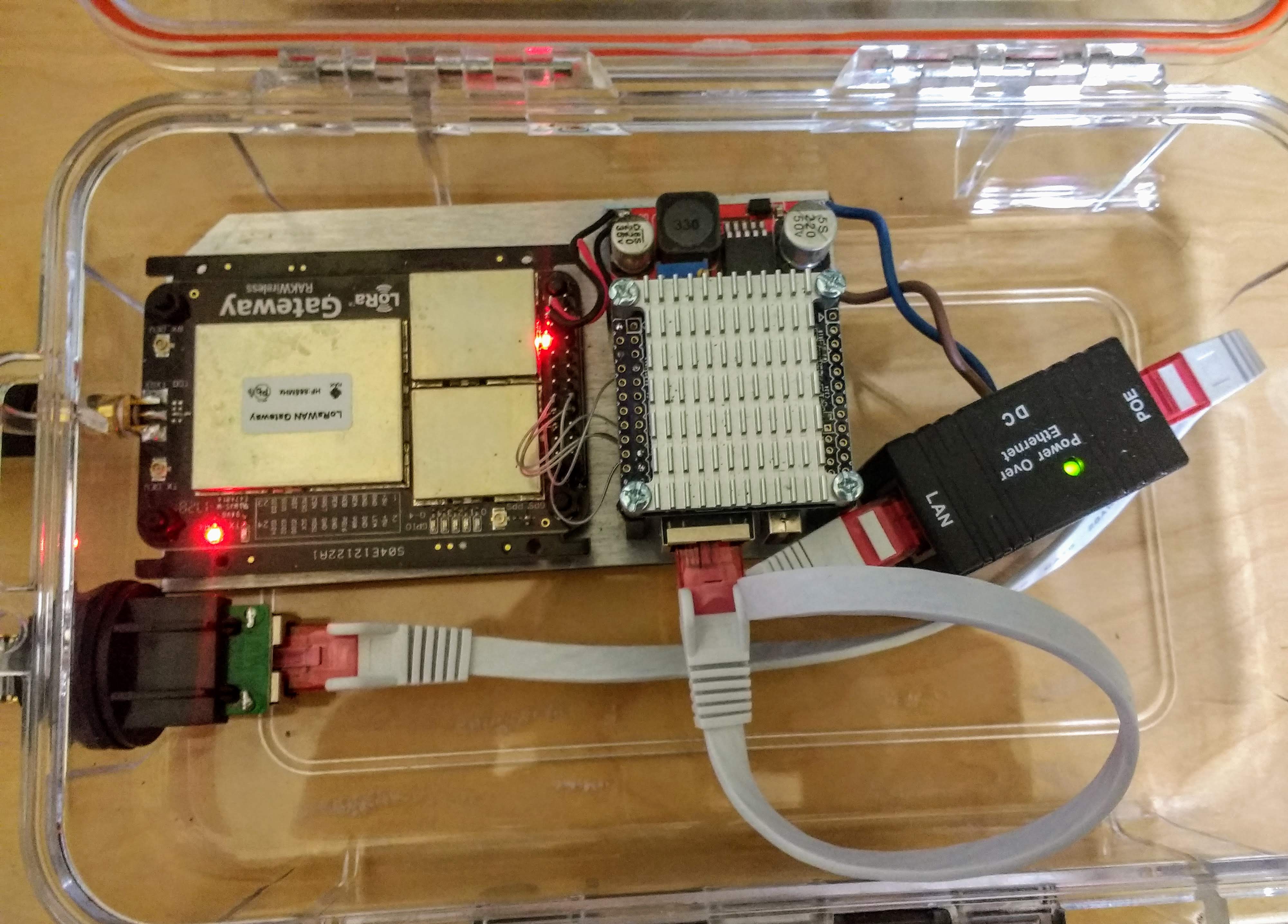

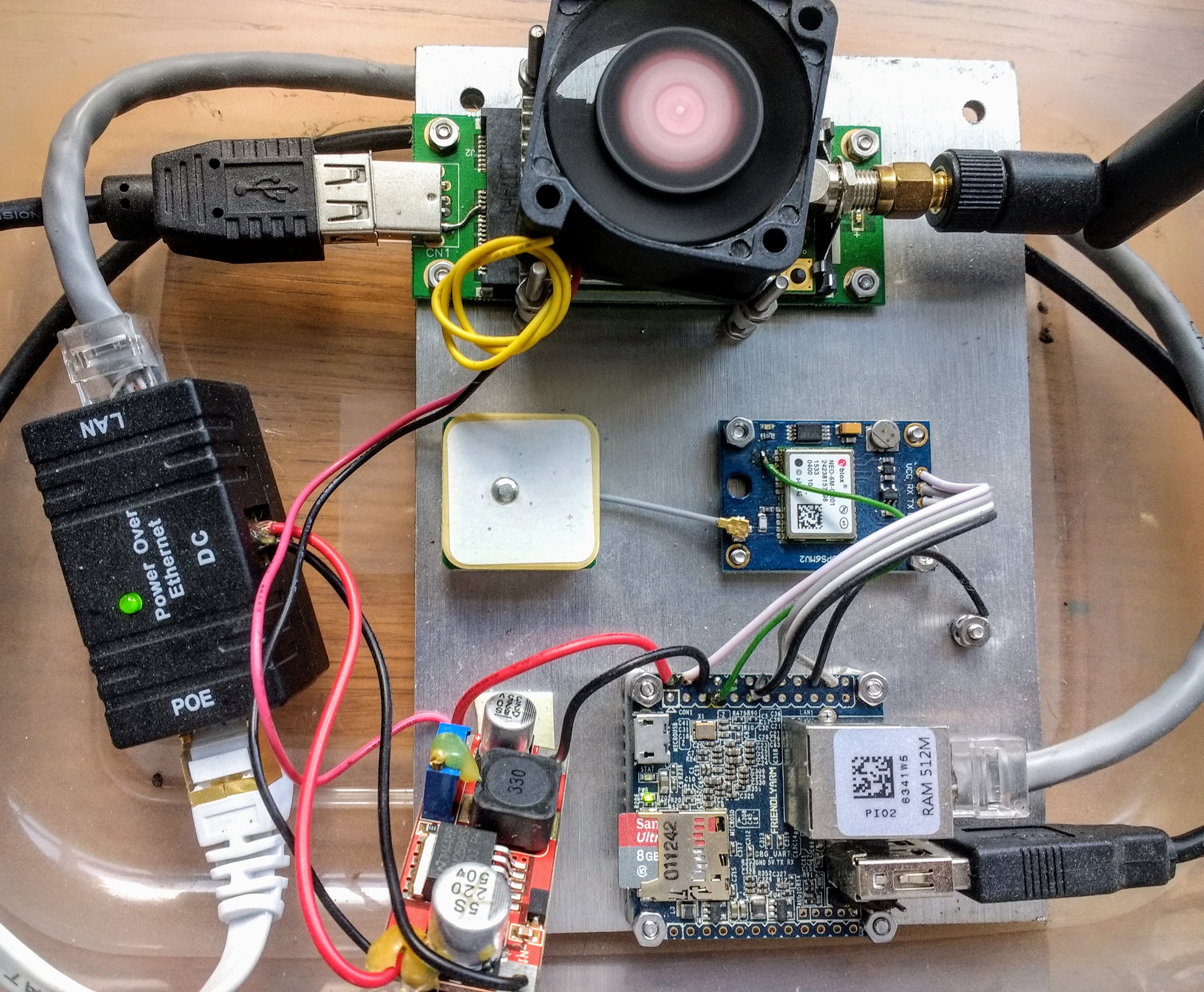

I use dietpi with both original Raspberry Pi and the nanopi devices from FriendlyArm. I have two LoRaWAN gateways, one based on the original Multitech LoRa PCIe device and the other on the RAKwireless 831 module both running dietpi on nanopi with log2ram installed.
I use dietpi because I know that someone better than me has built the distribution with kernel tailored for the specific hardware. I use log2ram based on my experience with NAND flash wear-levelling going back with thin clients over 20 years - and I like muffins!
