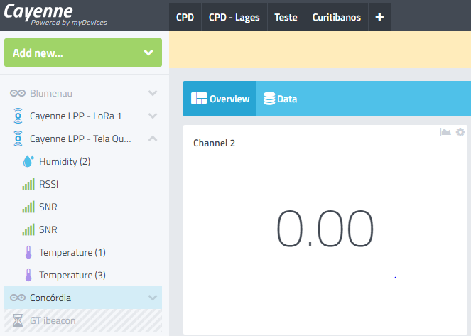

How Creat a simple channel in CayenneLPP
(Robsonmartinazzo) #1
When I put a value in my code, I get the Cayenne library, but it only has some methods, like this: https://www.thethingsnetwork.org/docs/devices/arduino/api/cayennelpp.html
e eu quero apenas um canal como essa imagem

I don’t I fully understand your question but you can ‘add new’ and then ’ add widget’ … name that Channel 2

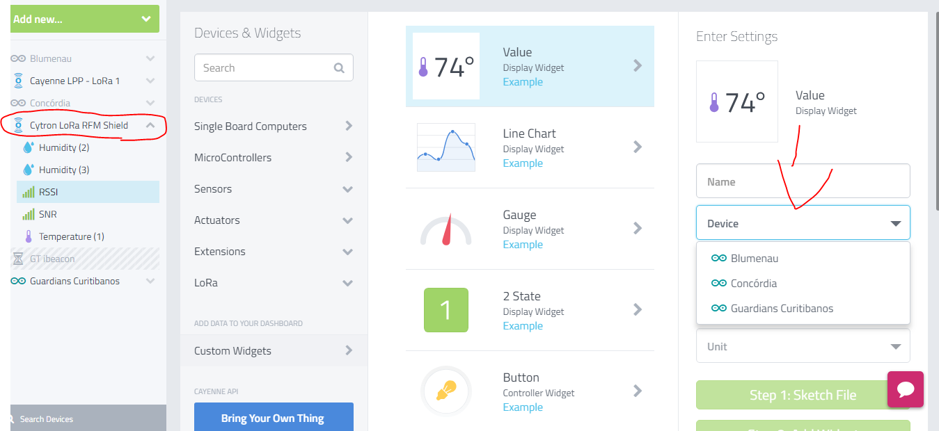

you want a ‘custom’ widget
(Robsonmartinazzo) #5
This just work in arduino device, when I select the option ‘Custom Widgets’,it does not show my device LoRa.
