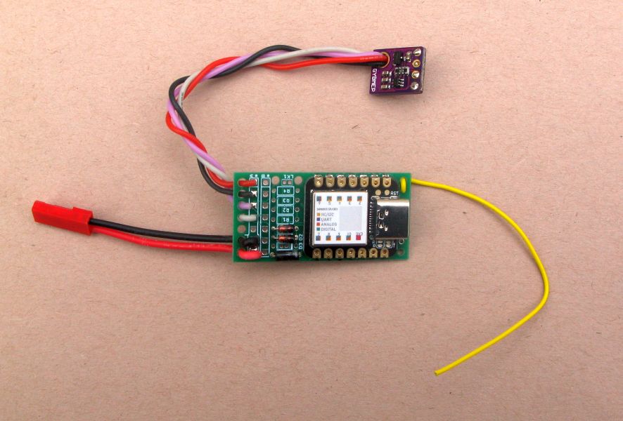

This is what a working TTN BME280 temperature node using the XIAO can look like (LoRa module is on the back of PCB);
min_build_node2
Deep sleep current 4.5uA, enforces the TTN fair useage policy.
You could use pin headers for the connections, but the soldered wires are a fair bit easier and no crimp tool or crimps needed.

I have written up my efforts so far, to make an easy build TTN node here;

Although the board I did is very simple, it probably makes sense to make it just a little bit bigger and add an edge SMA (for easy board mounting in a box) an I2C FRAM and a watchdog.
Not sure the SAMD21 internal watchdog is the answer, although I might give it a go. But for that to work the FRAM would be needed to store stuff, cannot have the node creating a new DevAddr every time there is a crash. My preferance would be an external watchdog such as the TPL5010, which could reset the node completly independantly of the SAMD21.
