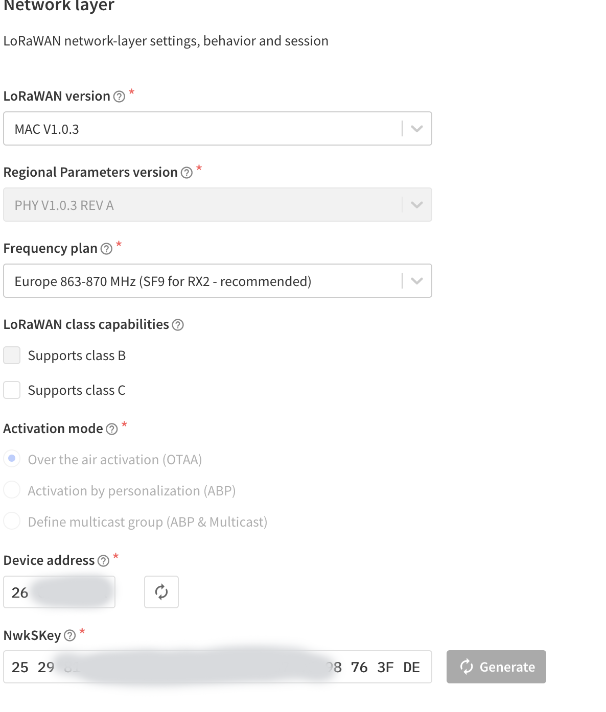

For my first application, I created a new OTAA devise and when I look at the Overview tab, I can see the “Activation Information” and the “Session information” as the Devise address.
Now I created a new application and I am trying to create a new devise. In that new devise I can not see Activation Information and Session information. Morever, the Application Layer is inactive.
Here is how I did (I generated a AppKey)
Screenshot 2021-09-06 at 10.27.43
Screenshot 2021-09-06 at 10.29.37
I wonder what I missed? I should find those information in my latest created devise?
Screenshot 2021-09-06 at 10.30.58
If I look at the devise I created some mounth ago, I can see that
Screenshot 2021-09-06 at 10.56.46
The devise has been registered as OTAA, but it has a devise address. But Devise address is not only for ABP???
I don’t quite understand what your question is.
Are you worried that you don’t see a device address for your new device?
OTAA devices need to be configured with an AppEUI (sometimes called a JoinEUI), DevEUI and an AppKey. With these data they can perform an OTAA (over-the-air-activation) and at that point they will get assigned a device address (typically 26 XX XX XX for TTN).
My guess its that you don’t see a device address, because your device has not performed an OTAA yet.
