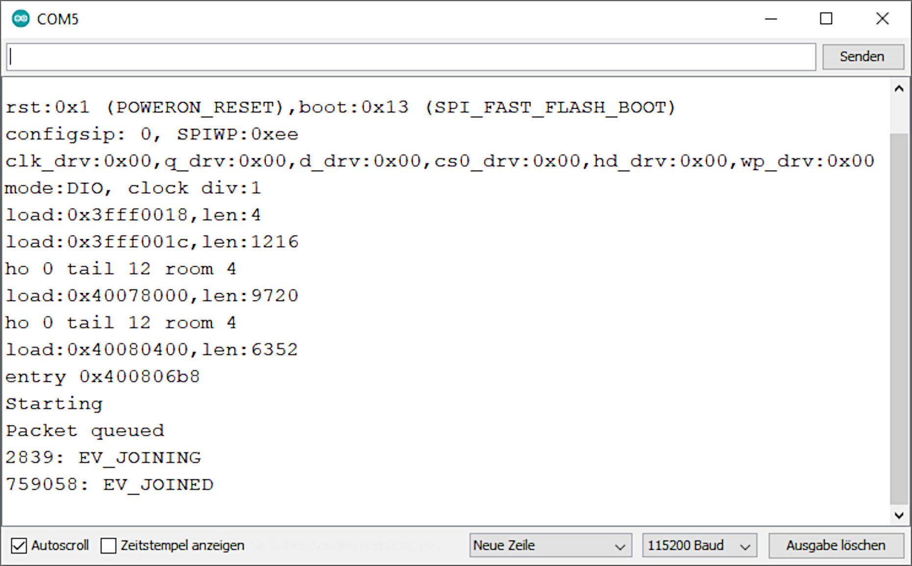

But I have the next question.
The EV_TXCOMPLETE-Event never occurs.
I have the following messages in my Arduino-Serial-Monitor.
Packet queued
2803: EV_JOINING
462043: EV_JOINED
Any suggestion?
Thanks in advance!
Erik

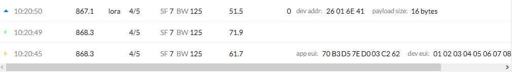

Where is your gateway, how close is it to your device, does the gateway / device consoles show the join request and the join accept?
Thanks for the answer.
The InDoor-Gateway is 10cm next to my LoRa-Node.
Here is my Gateway-Traffic
Ist shows join request, join accept and upload to the application.

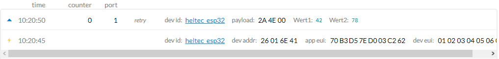

Here is my Application-Data
Thanks a lot for your support!

10cm would be like me shouting in your ear - very uncomfortable and likely to be a break down in communication. You need 5m or a brick wall or both between gateway and device.
The screen shots say it’s working - what did the serial log say for that test?
You mean in Serial-Monitor in Arduino
