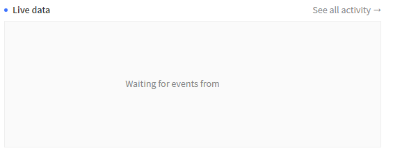

If you publish a downlink, does it appear in the device console?
That will tell you if the pub is working - then we can figure out the sub issue not showing the pub.
Seeing that there is no response, it seems that there is another problem with my situation. Thank you for your kind reply :blush:
Live data
Assuming the screenshot is from a time period when you issued a pub, you do indeed have a problem, the biggest one being filling in all the details so someone can help you:

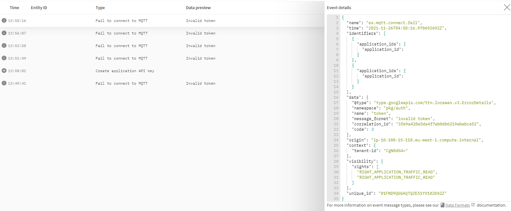

When I ran mosquitto_sub, these contents were added to Live data.
mosquitto_sub_ttn
(I’m glad something came out. :joy: :joy:)
There seems to have been a problem connecting mosquitto_sub.
[Data preview] says [invalid token], but I don’t know what this means. :disappointed_relieved:
What does [invalid token] mean and where can I check and fix it?
Is there any document that I can refer to to solve this problem? :thinking:
