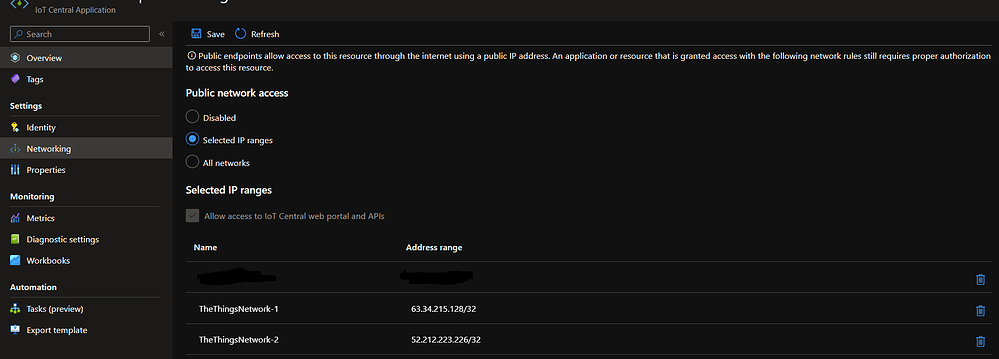

We went back to our network settings in Azure and set it to the following (in screenshot) after running an nslookup on our LNS address-eu1.cloud.thethings.network.
Even though we whitelisted the IPs from the nslookup, we are still getting failed connections into Azure IoT Central from our devices in The Things Network. Any ideas as to why?
A few extra notes: we cannot use FQDNs in these Azure whitelisting screens unfortunately and the connections from the devices work fine when the Azure network whitelisting is set to accept connections from all networks.
The DNS name is pointing to the front of the LNS. It might well be that there are other components that users do not need to connect to and are not in the DNS pool but are used to push the information to Azure IoT central.
You’ve done a lookup for IPv4, which isn’t really a thing for big stuff these days if it can be helped.
Plus you’re assuming that the public facing IP addresses that we tell our gateways and web browser to connect to are the ones that also send out information which is pretty unlikely given the cluster, components for separation of concerns, queuing, database nodes etc etc.
