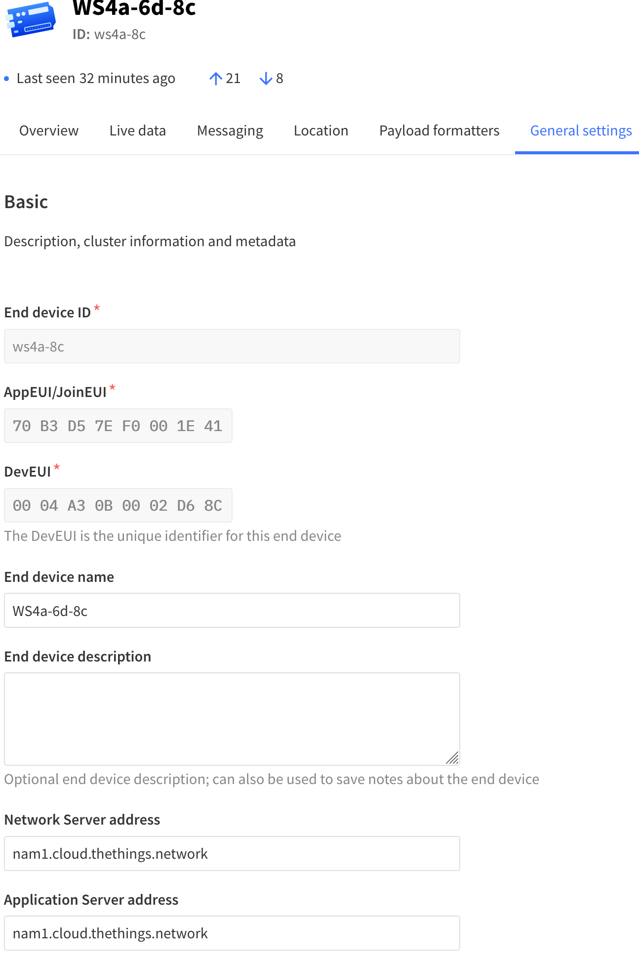

OK, I did try to move a device from EU1 to NAM1 using the GUI…
To start, I looked at the console in the nam1, and my device shows up there. That was interesting, My application decoder was not there, so I added it, with a flag to tell me what decoder did the work.
So I went to the console on the eu1 system and change the address for the Network and Application servers to: nam1.cloud.thethings.network
If I look now at the general information screen on the nma1 console, I see the changes…

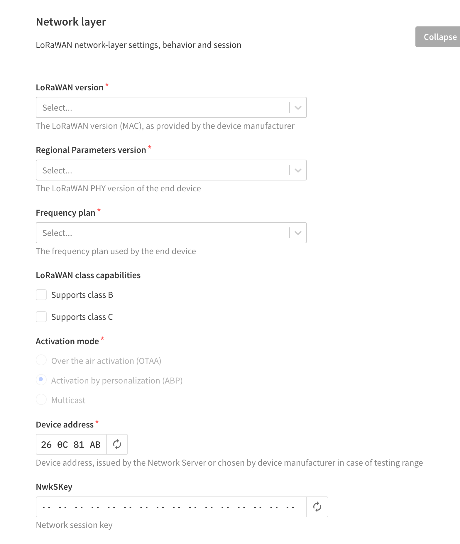

But, when I now look at the configuration in the nma1 console, I see that the information has changed, but network information is NOT set, and when I try to reset it, the ABP flag is set and I can’t chat t to OTAA. When I try to save any of the pages, I get an Invalids Field Mask. All of the data is still a process by eu1, as well as MQTT data. The eu1 tells me my device is not part of the cluster. but I can’t finish setting up the device on teh nma1 system.
So it looks like I am in never-never-land with this move… half in half out…

Given that TTI provision the servers in each region, I suspect you’ve altered the settings in the EU database but nothing got moved to a completely different database on a server 6,000+ miles to the west.
If you care to answer the question about how many devices more help may be forthcoming.
I have just a dozen active device to move… this one was just a test unit…
what happen if I just delete them in the EU1 system and re adds in NMA1 ??
That’s what I would have done from the start. nam and eu are two different networks. Best to just create from scratch on the correct network.
Yup, now we know it’s just a handful, easier to do it with a copynpasta session…
BTW @trlafleur, it’s NAM1 - best to get the nomenclature correct for future scripting.
Ok, I deleted all the units from EU1 and move all of them except two of them, they get an error when I try to save…
Network layer settings
Frequency plan, regional parameters, end device class and session keys.
"code": 3,
"message": "error:pkg/networkserver:field_mask (invalid field mask)",
"details": [
"namespace": "pkg/networkserver",
"name": "field_mask",
"message_format": "invalid field mask",
"correlation_id": "a275ea71e4a8422f8b0a350744fec4fb",
"cause": {
"namespace": "pkg/ttnpb",
"name": "prohibited_field",
"message_format": "field `{field}` is prohibited",
"attributes": {
"field": "multicast"
"code": 2
"code": 3
"request_details": {
"url": "/ns/applications/rsf1-otaa/devices/ws4a-b0",
"method": "put",
"stack_component": "ns"
