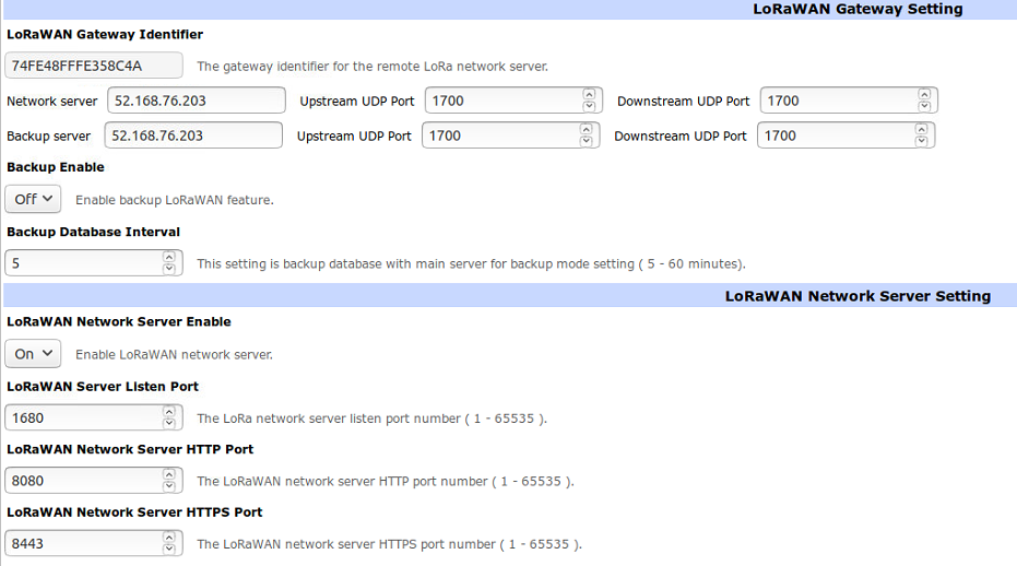

I should connect an Advantech 6610, I done the setup of the gateway and I got Gateway ID and Key, but when I connect to gateway via browser it seems that it haven’t any field in which I could insert that values, I read about packet forwarder, should I have to install it inside gateway in some way?

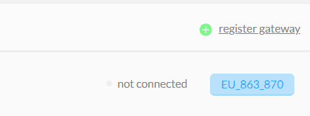

I managed to connect this gateway to the internet but now I don’t know what it’s needed to “signal” ttn console to change its state, until now, is “not connected”.

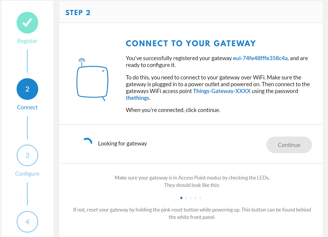

I noticed a gateway activation procedure, but it doesn’t work (but I guess it’s useless for this specific gateway):

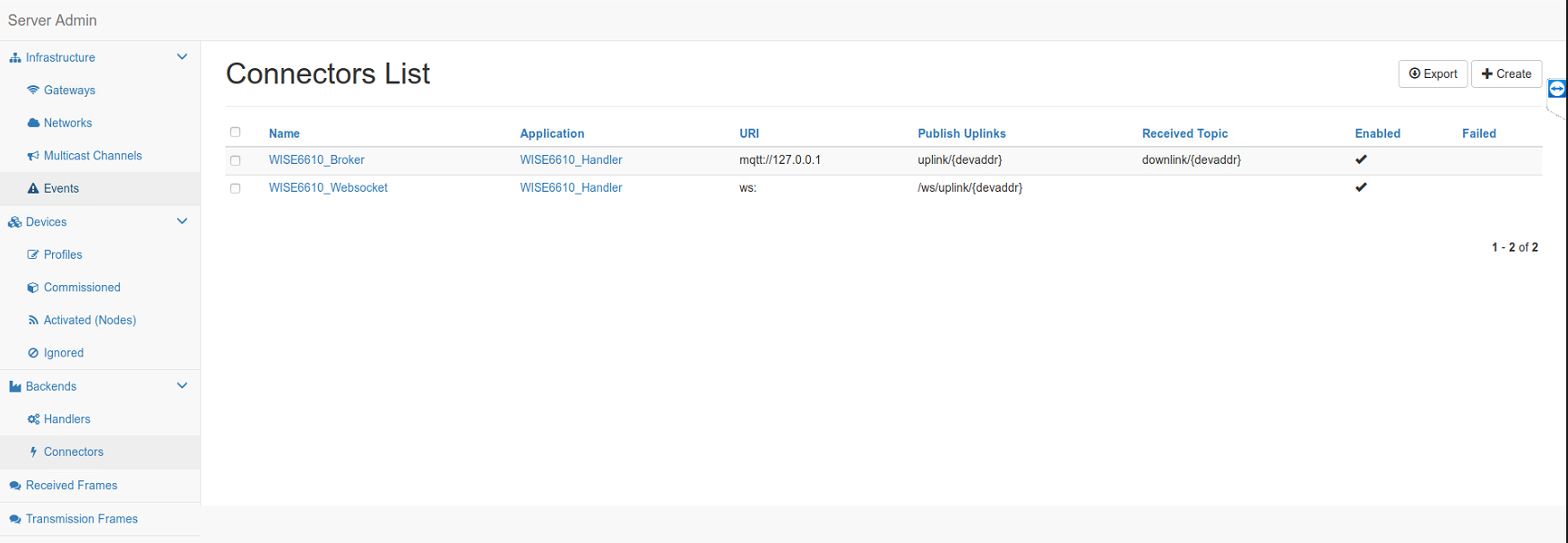

As you can see there is also, a local Network Server, with other settings, here (for example) I could set a “connector”, I think this server act as “intermediary”, i.e. decrypt packets from node and send to another server or application (just set 127.0.0.1 in the address line you seen in previous screen) I try to set there IP address but still appear not connected.
Does ttn server (52.168.76.203) require some authentication? Could it is a protocol problem (MQTT / HTTP)? Or “connected status” is triggered from first packet sent from node to gateway? I haven’t a node for now, I only want to see a connection flag in that screen (first screenshot).

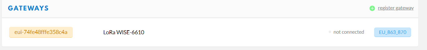

Gateway EUI seems to be 74FE48FFFE358C4A although isn’t so called (see third image in my post above “LoRaWAN Gateway Identifier”) and yes, I chose legacy mode.
I have talked with support team of the producer of this gateway (advantech), they have sent me a guide that confirm that in this gateway there is the semtech packet forwarder.
I have followed the simple guide (I only had to write the ip address of ttn server eu 52.169.76.203), so the IP address and port are correctly set as the EUI (I can see it in line edit above), but I see still “not connected” (see above).

I’ve just solved the problem, until now I had no node able to send any packet.
Some minutes ago I received one, as soon as I turned it on was sent first packet and the status on TTN console changed to “connected”.
Apparently, the legacy packet forwarder needs to sent something before TTN shows status change.
Thank you so much for support and kindness.
Ah, that is the very basic packet forwarder which indeed suffers from this symptom. This means the last seen field in the console will only be ‘reset’ when a packet is forwarded as well.
