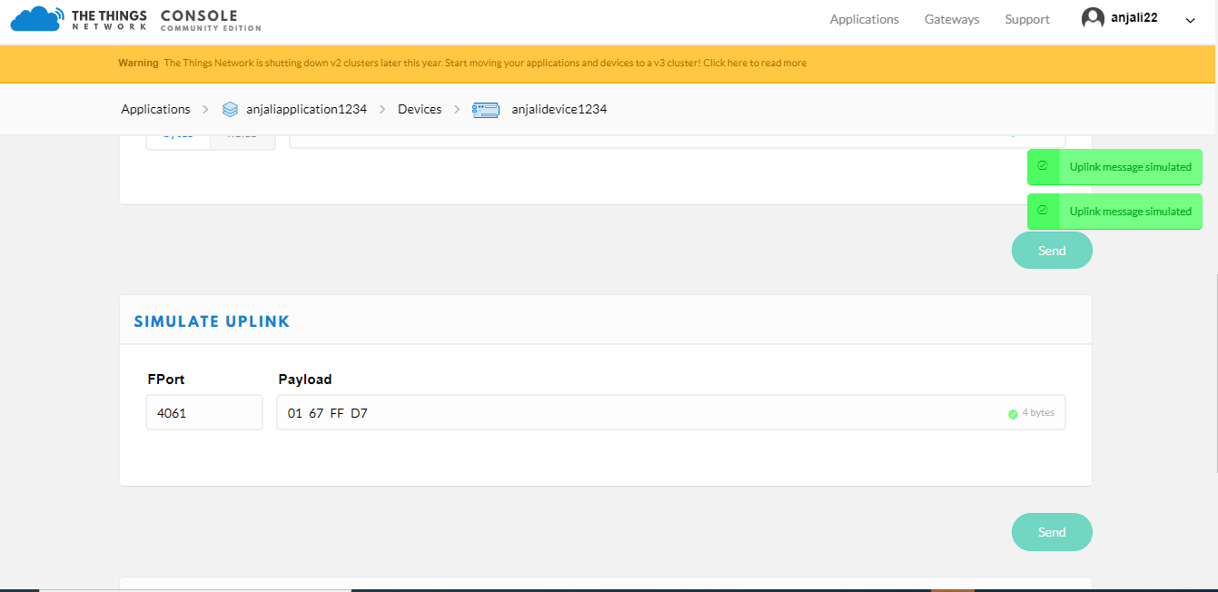

Hi @bertrik Thank you for the response.
I have followed these steps but it was not working. I have used payload (bytes as hex) and port in uplink. it shows uplink message simulate but there is no change reflect in value.
PFA screenshot for the same

The port value is totally out of range, it’s not TCP port, it’s LoRaWAN port - just try 1

Yes, we’ve told you how to do that, you’ve gone to the right place, you’ve apparently tried with a proper port number (as 4061 is way out of range). Please answer the questions I wrote above.
