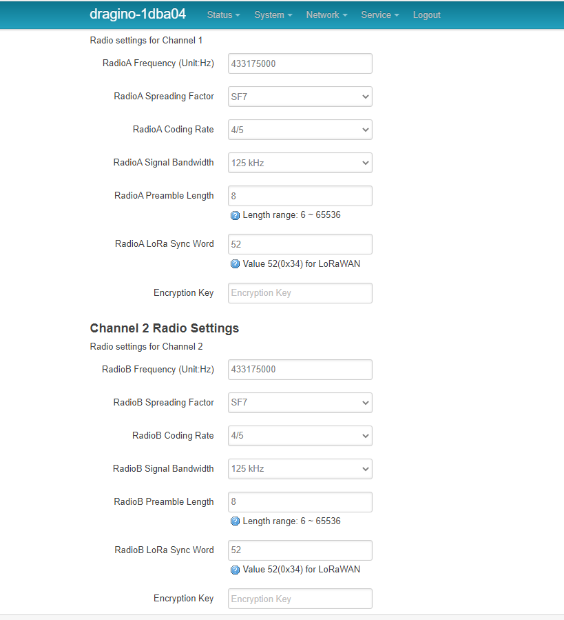

In the configuration section of dragino I configured the frequency as image below.
TTGo I use LMIC library and I have modified frequency in file lorabase.h from 868 to 433

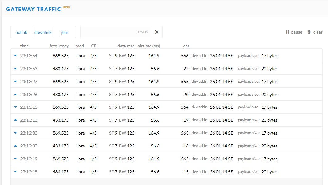

When I run example uplink_apb on arduino. Data uplink is working on Application TTN but downlink end node not received data from TTN (LMIC.dataLen = 0). As I see frequency downlink is 869.525. It made error, right?

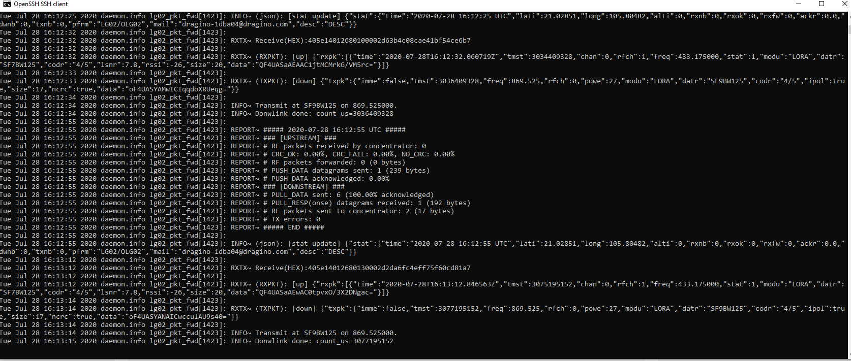

here is Dragino log

That would simply be that the device & the gateway are configured to use 433, the device transmits, the gateway receives, the gateway relays the uplink on to TTN which probably can just cope with the rather odd frequency that was added to the meta data.
But when the downlink arrives, the gateway is unable to match the requested downlink frequency to its local frequency table and just falls over.
