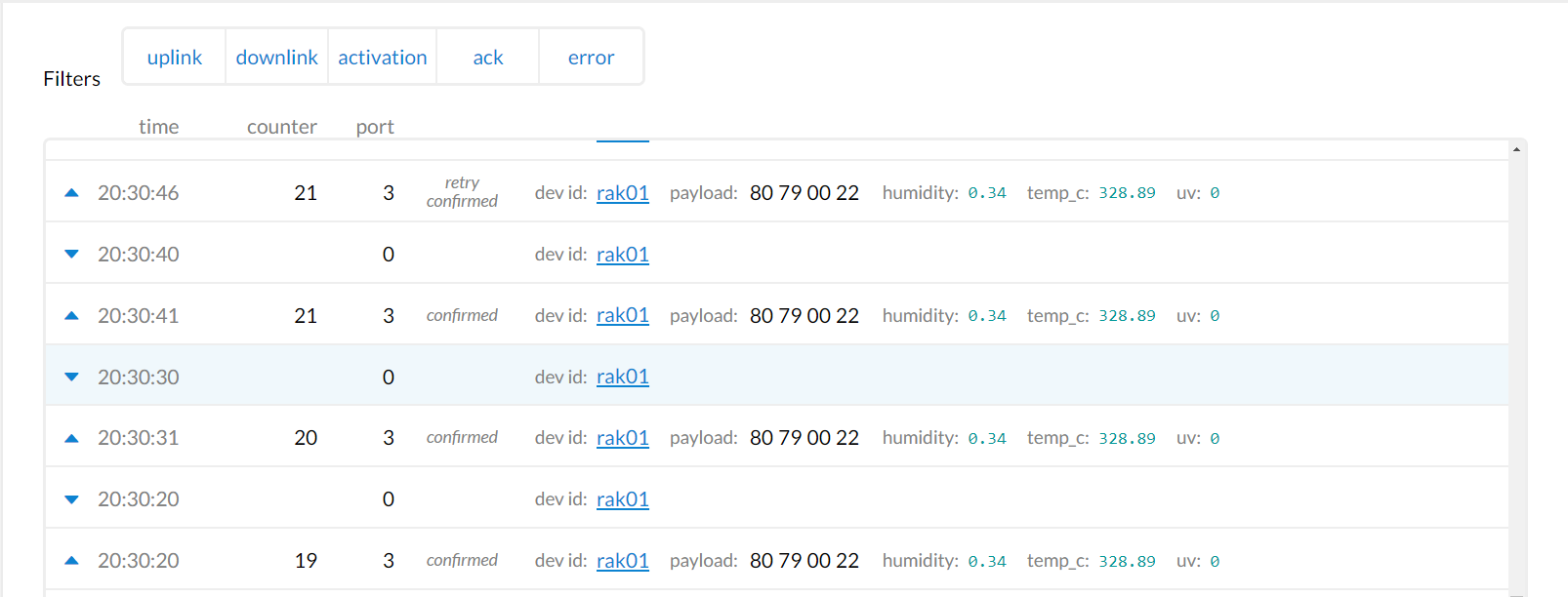

How to stop getting a downlink for each uplink in Arduino with RAK811
Hello everyone, I hope you are very well.
I tell you that I am working with Arduino MEGA and I need to know how to UPLOAD data without receiving the DownloadLINK of the data I use the RAK811
ttn-3
This is the program

The downlink you’re getting is the confirmation of the uplink, just like your code requested:
Indeed, requesting a confirmation for each uplink is not good. I’d guess that changing the 1 to a 0 would do the trick to disable it.
Note that TTN Console also tells you that the device sent a “confirmed uplink”. And that your device did not receive all the confirmations, making it repeat the previous uplink, like with the very same frame counter value of 21:
retry
Clicking an uplink or downlink in TTN Console often reveal more details.
