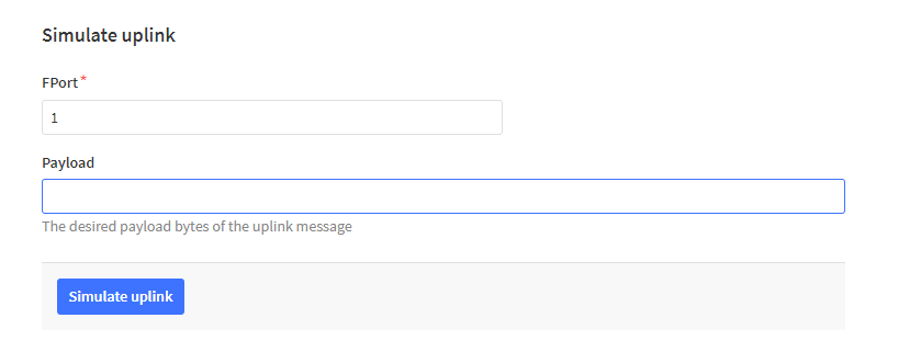

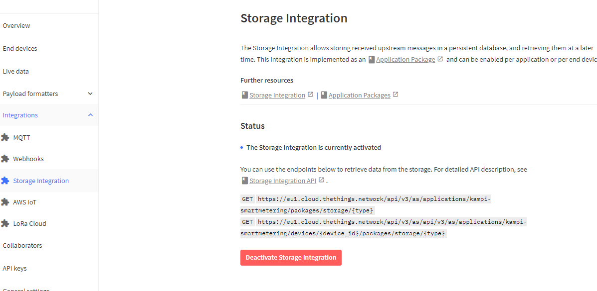

I have an application with a LoRaWAN device and I want to use the storage integration to store the data. The storage integration is enabled by opening Integrations → Storage Integration → Enable and I can simulate live data which gets stored.
I can see the data by using the API, but the data from the device aren´t stored in the database.
How can I forward my device data into my database to store them?

I´m referring to this database
I thought that the storage integration will store the data in my account and then I can access them as I wish.
And you can access it as you wish - not only is it all detailed in the documentation but there are even some sample web addresses being displayed on the console for you.
