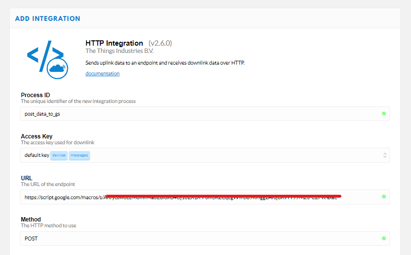

Thanks for your replies. Please note that i had everything working properly in v2 and i am unable to recreate it in v3. I added a screenshot of the configuration i used in v2.
