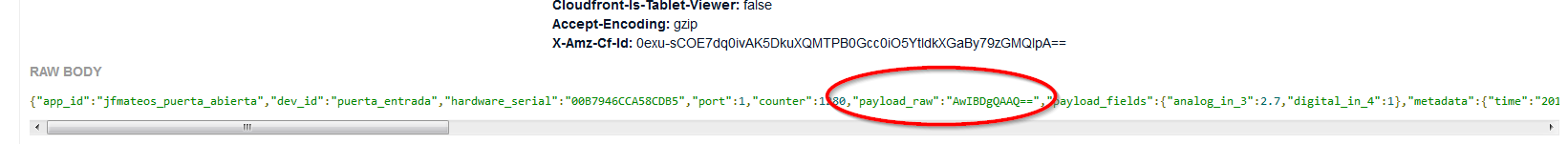

Hi, I’m Moisés from the community of Figueres (Spain). I’m doing an http integration and I wanted to ask a question: in what variable are the raw uplink data that are published, in data? What I want to do is collect them for example in classic asp with a request.form. Can someone help me or guide me in the solution? Thank you very much in advance and sorry for my English.

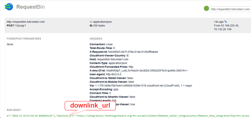

Hi Moises, you can use requestbin to explore the HTTP post data
Kind regards from Madrid
Hi Juan, thanks for your quick response. I had already used requestbin, but what I can not do is save the JSON generated by the post when doing the uplink. With other APIs I save the generated data with a request.form and store them in my database. Any idea how to save the JSON? Thank you.

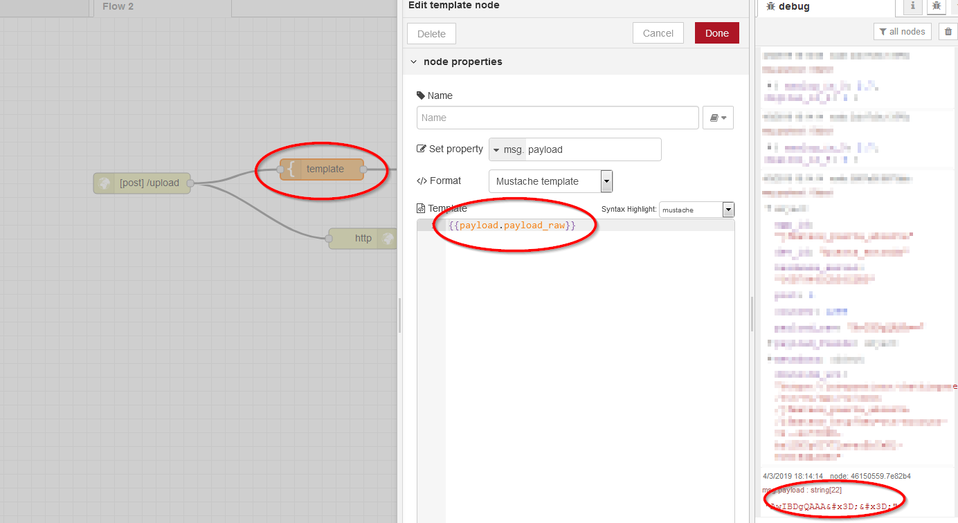

I don’t use asp, but for example using Node-Red you can do it with a simple template node, getting the payload_raw property
