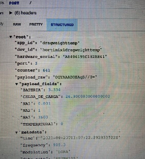

Hello! Im not really very into the programming stuff… im more of an electronic guy but the person that is helping me out with the programming is having difficulties when looking for the values… every time he tries to extract a value from a field he gets the value AND one of the correlation_ids (which I dont know what it is)…
Above some images. We are trying to get the device_id but we are also getting the first correlation id… what is the correlation id anyways??
Above an example of how it is in V3:
And how it was in V2:
Sorry! Everything is good now!! He deleted the whole code and rewrite it and now it is working as it should…
I still have the question about what are the correlation_ids?
