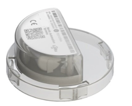

My customer have the attached water meters that supports only OMS 434 Mhz . is there a way to recommend a module to transmit the data over lora. or this will be complicated? Cause I also heard that the send a data to tablet in an encrypted format.
