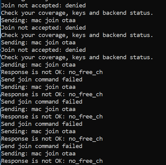

Below is the OTAA connection log! Stay in this loop forever
______________ OTAA connection log _____________
Starting
Packet queued
189: EV_JOINING
433: EV_TXSTART
516548: EV_TXSTART
9826011: EV_TXSTART
10206155: EV_JOIN_FAILED
10529685: EV_TXSTART
11056731: EV_TXSTART
20380341: EV_JOIN_FAILED
12062704: EV_TXSTART

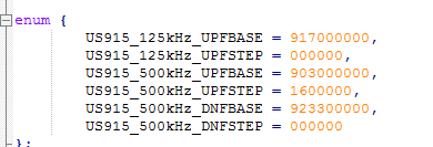

I blocked the TX / RX channels, so every msg that is sent arrives in the TTN
My gateway is configured :
Canal TX -> Freq 923300000 / SF12 / Cod Rate 4-5 / Bandwidth 500Khz
Canal RX-> Freq 917000000 / SF17 / Cod Rate 4-5 / Bandwidth 125Khz
