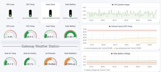

Before Basics Station was available and while developing my gateway which is rated for outdoors in direct sun at 45C ambient I ran MQTT to a server to log and display some gateway data. I can confirm MQTT is a good solution.
gatewaydata
