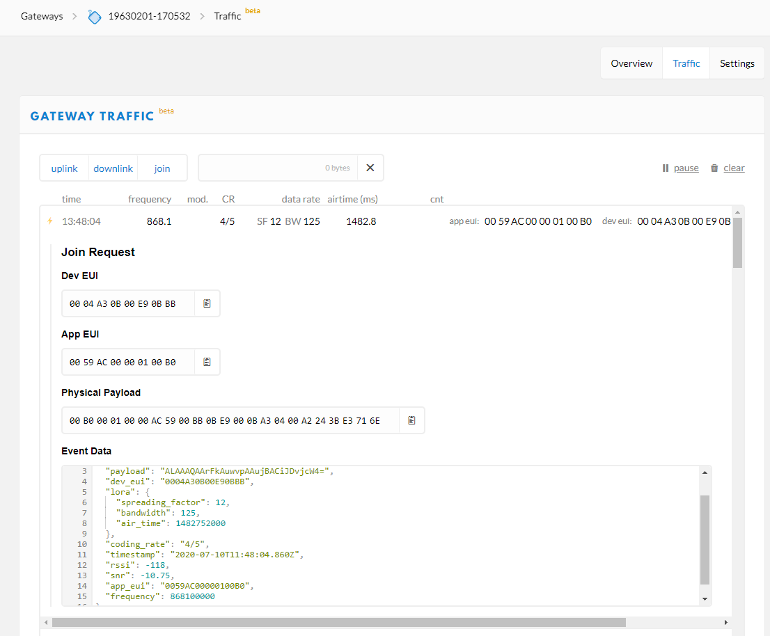

is there a way to identify packages that arrived at the gateway ?
I’ve received a package from an App EUI and Dev EUI that are certainly not mine.

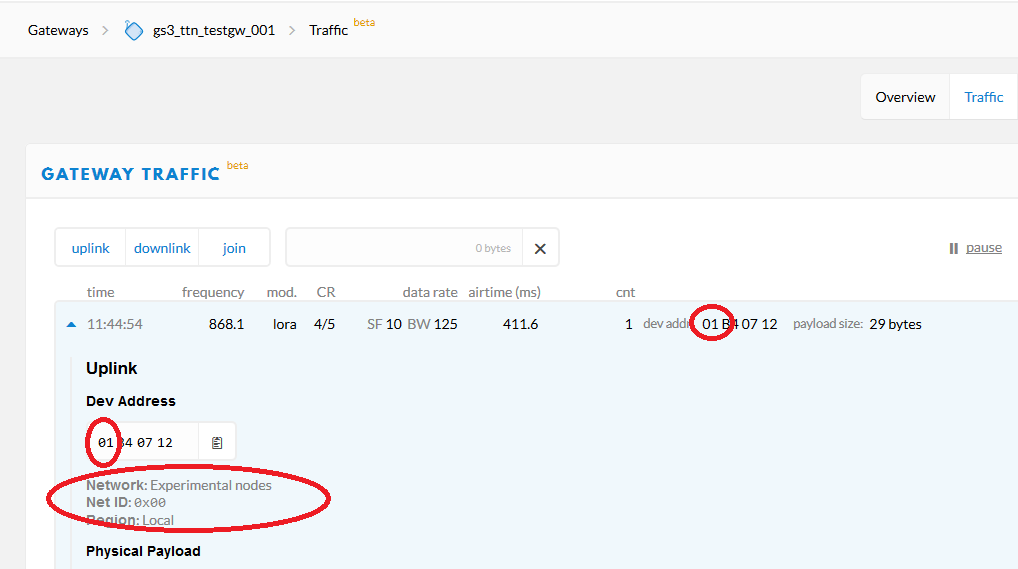

You can look at the Dev Addr in GW log for clues to host network - usually called out if you expand the log line and a LA registered network. For ref if you see Dev Addr starting 00 xx xx xx or 01 xx… that will be classed as an ‘experimental’ node and may not be specifically registered. If you see 26 xx… or 27 xx… that will be a TTN(or TTI)registered node.
e.g.
or
You can then always contact the host network to trace the end user (e.g. in case of abuse of local air time regs etc.), other than that find out ‘who’ is unlikely - though you can always post the dev Addr and ask if anyone knows or claims ownership. If node is registered against e.g. TTN Mapper that may be another route to identifying who owns…

Note that a DevAddr is not unique (like for the EU-region TTN only uses at most 4,096 different values for all ABP devices). Also, a DevAddr will change for each OTAA Join. (Though a device should not need to re-join very often, if ever.)
You’re seeing an OTAA Join Request, which apparently either is not handled by TTN as the device is not registered to TTN, or for which TTN has commanded another TTN gateway to send the Join Accept (if the request was received by multiple gateways). The DevAddr is only assigned after the join request is accepted by a network, so at this point TTN Console cannot show any network details. You will see the DevAddr for data uplinks.
If the device happens to use a TTN-assigned AppEUI, then it starts with 0x70B3D57ED. But a device can also use its own AppEUI when registering on TTN.
