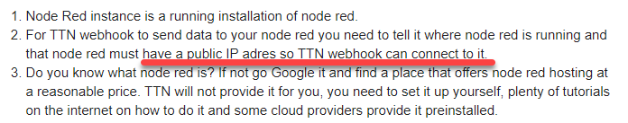

  1. Node Red instance is a running installation of node red.
  2. For TTN webhook to send data to your node red you need to tell it where node red is running and that node red must have a public IP adres so TTN webhook can connect to it.
  3. Do you know what node red is? If not go Google it and find a place that offers node red hosting at a reasonable price. TTN will not provide it for you, you need to set it up yourself, plenty of tutorials on the internet on how to do it and some cloud providers provide it preinstalled.
Then may-be when you found how to do it you can write it for others.

  1. The webserver is needed to translate the TTN V3 data to the correct format for IFFFT
  2. No you have to have node red (acting as webserver) yourself.
  3. Generic node red documents are available on the internet, Google will find them. The steps on what to do in node red are at the documentation site you linked to earlier.

https://www.thethingsindustries.com/docs/integrations/ifttt/tts-setup/
This procedure tells to use ā€œhttp://127.0.0.1ā€
(1)Is it a public IP address TTN webhook can connect to?
(2)If yes, tell me how can I realize it.
  1. No it isn’t.
  2. Please ask someone with a bit more knowledge in your local community to help you. Explaining these basics is easier done by someone showing you how to do it. Ask in the community if anyone can help you setup node red at a cloud provider.

The V3 procedure does work but assumes basic IT knowledge.
The link to the IBM site contains the steps you need to set up node red. That needs to be done first. Then you can use the steps in the TTN documentation where you need to replace 127.0.0.1 with the URL of your node red installation.
The example given in the documentation means the Node Red server was running on the same network as the TTN Application Server (to be precise, the same computer) - this is typical of a lab setup for demonstration. But you can’t run a computer inside the TTN network which is why it has to be on the internet.
